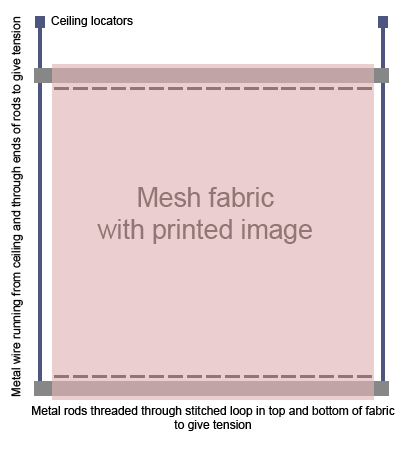

    I have fitted some mesh privacy blinds, which had logos printed on but were still see through.
    Everything on it looked like a standard fixing, although i have never supplied these, only fitted, so i don’t know where you would get them (sorry)
    I have attached a quick diagram of the system, hope it makes sense.
    The blinds were about two meters wide and were used to partition off open plan offices or hung in windows as decorative blinds.
