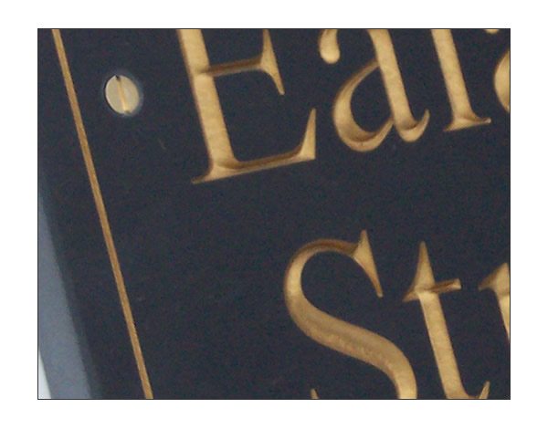

    I’m thinking of buying some second hand equipment to do a little sandblasting onto slate (house signs) and perhaps a bit of glass.

    So basically you are saying that to do the kind of blasting and get the results pictured I would require a large set up. I would prefer to do this in a cabinet in my garage – do you think this would at all be possible?

    To do work like in your image you can also do a markup with the blaster and then afterwork it with chisels, you get a smother surface for the gold and better result in the end.

    The pic you posted looks like a carved sign. That requires carving chisels or a router, not a sand blasting. Carving is totally different process that requires totally different skills. On the plus side, the process is a lot quieter and cheaper to get into when compared to Henry’s set up 🙂
