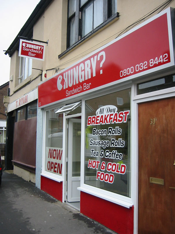

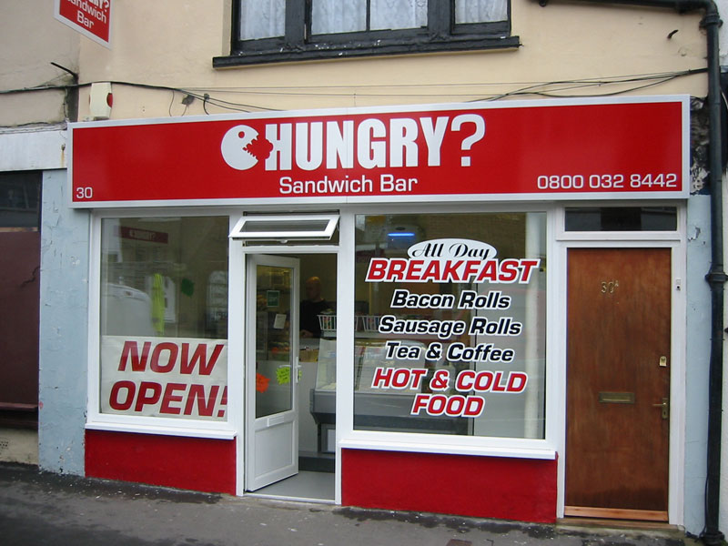

    Following on from Richards post regarding composite trays, I thought I’d post a picture of my latest effort.
    The trays were made from brushed finish metal effect reynobond. ( even tho they look white in the pictures.) The only mistake is that I used the factory edge on the butt join which I later found out has a slight bevel. . . this shows up quite a bit on the shiny brushed metal finish, makes it look like there is a gap!
    This was all customers artwork, window decals are also temporary, he just wanted something bright and in-ya-face for the first few weeks on trading. I’ve got to clean this lot off and put frost effect on instead next month.

    I didn’t use a frame with this particular sign. It’s just folded reynobond mounted over an existing wooden sign fascia.
    Fabricated as per the thread below.

    just a tip ask your supplier to square edge them when you order your sheets. I have full sheets & cut sheets done that way no jointing problems

    just my personal preference but where ever possible I would never have the join running through the letter
    I would tweak the kerning or adjust the size of the panels to suit
    looks good though

    Yes the silver border and text are just the reynobond sheet showing. ( only red is vinyl) Quite a cheap solution, 2 sheets on composite board and 5 metres of vinyl. . this makes for a reasonably priced sign which I can still make a good profit on. .. so everyones happy 🙂
    I try to sell these signs over panatrim / frame style signs. IMO they look better, seem less hassle to install and cover old fascias up a treat.
    In my experience I only order in welded ali trays if A) I need a colour matched sign, in which case i’ll have the manufacturers powder coat / spray it which works out cheaper. B) if the customer has specifically asked for it.
    Aluminum trays are also much heavier.
