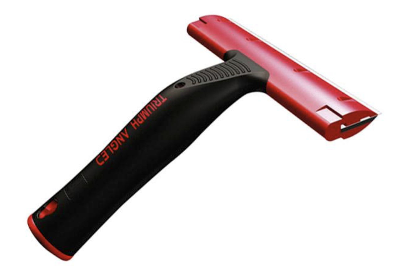

    spandex sell it, vinyl remover
    Triumph scraper otherwise with stainless steel blades, can point you in the right direction if need be for these

  • Iain Pearson
    April 19, 2019 at 10:10 am
    We use one of these and some warm slightly soapy water – ive yet to find a better scraper for removing glue
