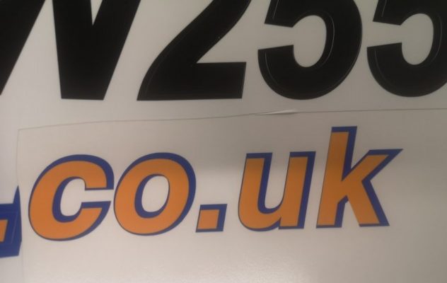

      I have come into work to catch up a bit and thought I would try cutting another job for the sake of it.
      Yet again, another 2m of vinyl, overlaminate, ink and my time wasted!!!!
      As you can see from the photo,
      the blue line around the text is supposed to be the same thickness all the way around.
      I don’t think I’m being unreasonable!!
    July 29, 2023 at 7:48 pm
    Might sound daft, but are you reprinting from the same file on the rip?
    Try deleting the original file from the queue and add the file again as a new job again
    • Christopher Hall
      July 30, 2023 at 11:50 am
      Yes, I’m printing from same file.
      Nothing seems to make a difference. I can send the job and it will cut completely mis-aligned. I can abort the cutting and resend without altering anything and it will line up perfectly – reasonably anyway! Albeit needing to re-do the mis-aligned section.
