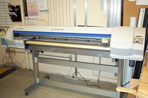

    Posted by Marekdlux on March 11, 2006 at 12:54 am
    I just got our 54″ VersaCAMM installed. 😀
    I’m sure I’ll be here asking questions soon.
    VersaCAMM party this weekend, prints, I mean drinks on me! 😉
    -Marek

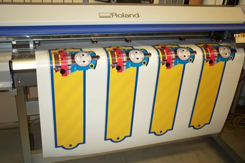

    I have not had much of a chance to play around with it, I am printing my first “solo” job right now after reading all the manuals. It seems pretty straight forward. I have only ever used Gerber Omega software as a rip so it is totally different. I assigned my cutline in Illustrator. We’ll see how it cuts, it’s about 40% printed right now. I am taking pictures so I will try to post some up afterwards with comments.
    -Marek
  • Marekdlux
    March 11, 2006 at 9:57 pm
    I couldn’t get my cutline to work so that is something I will have to figure out on Monday with the tech.
    Amazing color! I printed the same file up on the edge and I like the VersaCAMM better. The edge is limited on the dpi (300 for ours, 600 for Edge 2 and FX). I printed the file on the VersaCAMM at 740.
    -Marek
