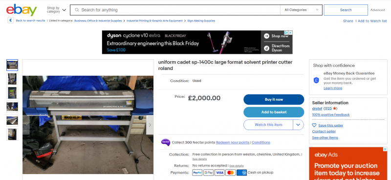

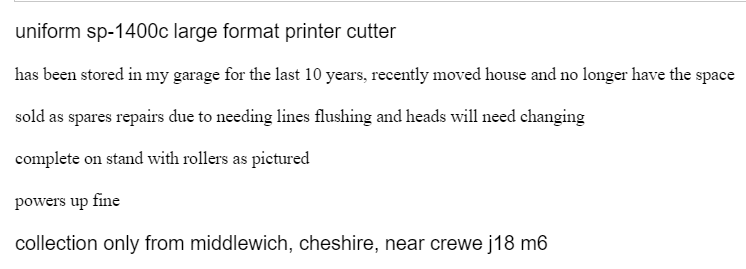

    Sorry, can’t give you any suggestions on the issue, Phill. But unless I’m reading this guy’s wording correctly, he may sell you parts, if you need any. That said, I guess the problem is knowing if a part is even needed. 🤔 https://bit.ly/3UIb054
