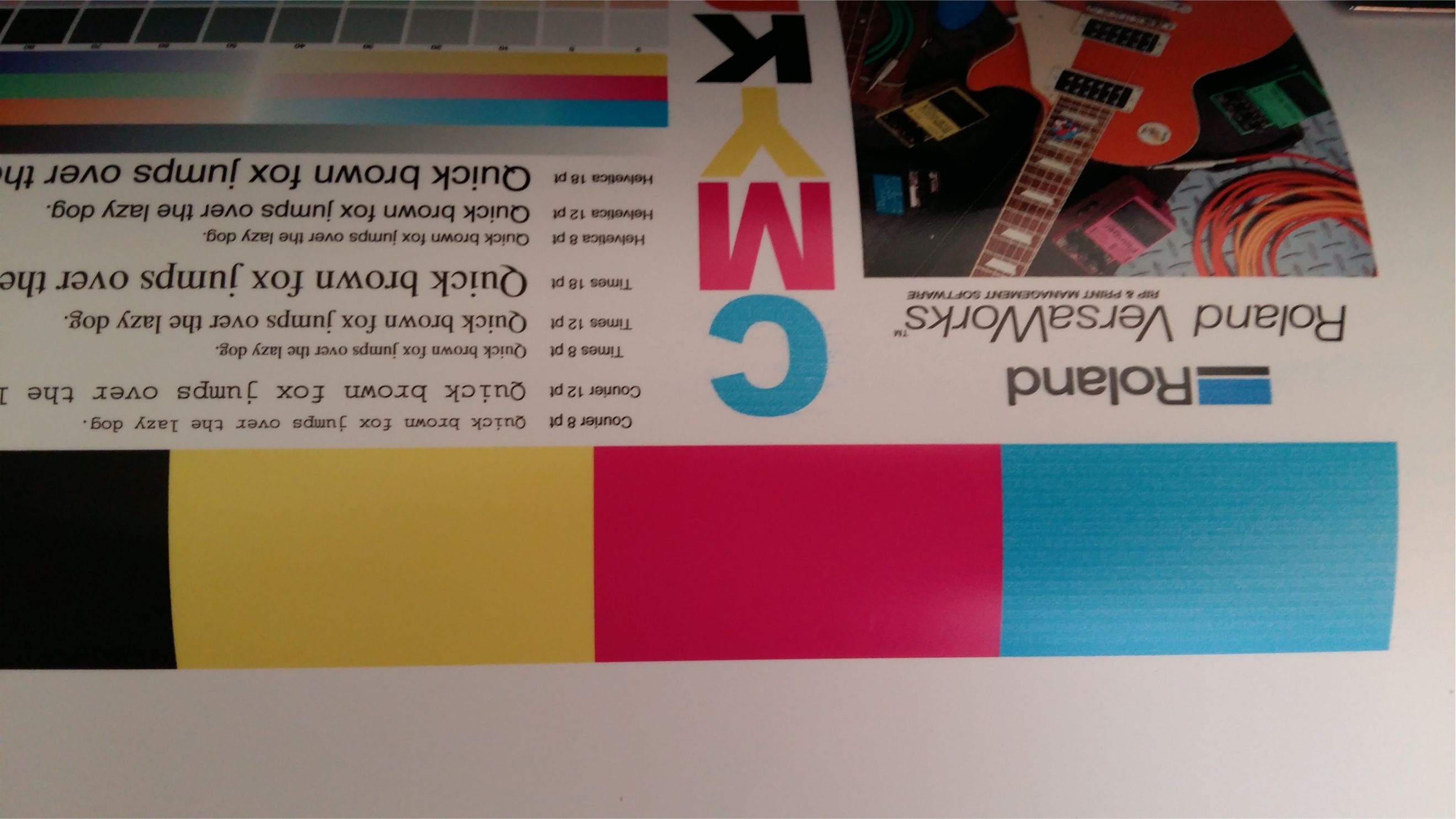

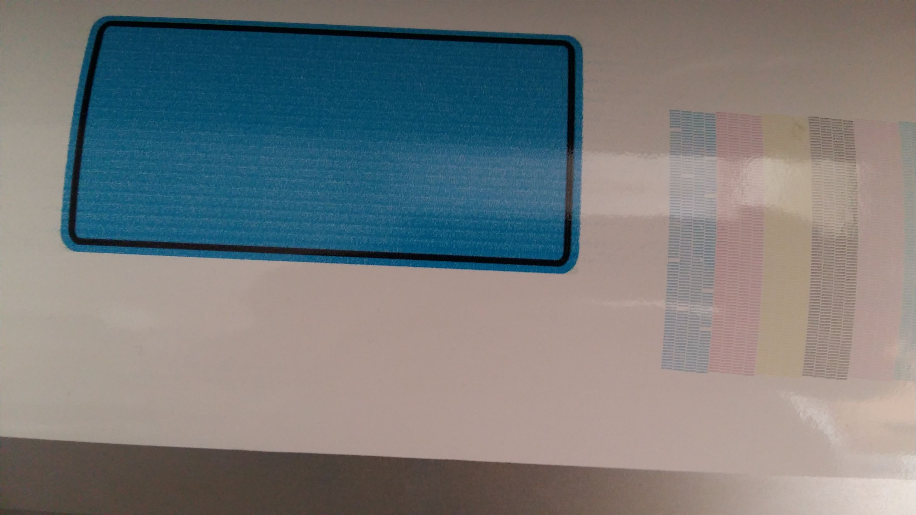

    in vs 640 i have banding blue about 4,5 days ago,
    the roland tech advised to replace captop,
    after changing captop nothing changed….
    any help …, suggestions …advice
    here attach. photo and the last test…
    thanks in advance,

    Hi Salman
    What was the nozzle check like before you changed the captop? You obviously have some nozzles missingin the cyan. Have you done a normal x 2 and possibly follow with a medium clean since changing the captop? Did you wet the captop with roland cleaning fluid after changing (some don’t but I do). If it was me I’d try that then leave overnight and try again see if any nozzles come back. Give edge of captop seal a good wpe with a foam swab in cleaning fluid as it has a lubricant to ensure good seal. Following that I’d try a head soak. Did you change your wiper and felt at same time – what condition were/are they in. Feed calibration looks good.
    Sure more expert advice will be along soon but good luck!

    Looking at the print i would be looking to see if you have any fluff on the head as you have smudges up to the print, this is normally caused by debris on the head or static. I would soak the head over night to see if you can get nozzles back, have you checked to see if the capping station is actually creating a vacuum
    Kev

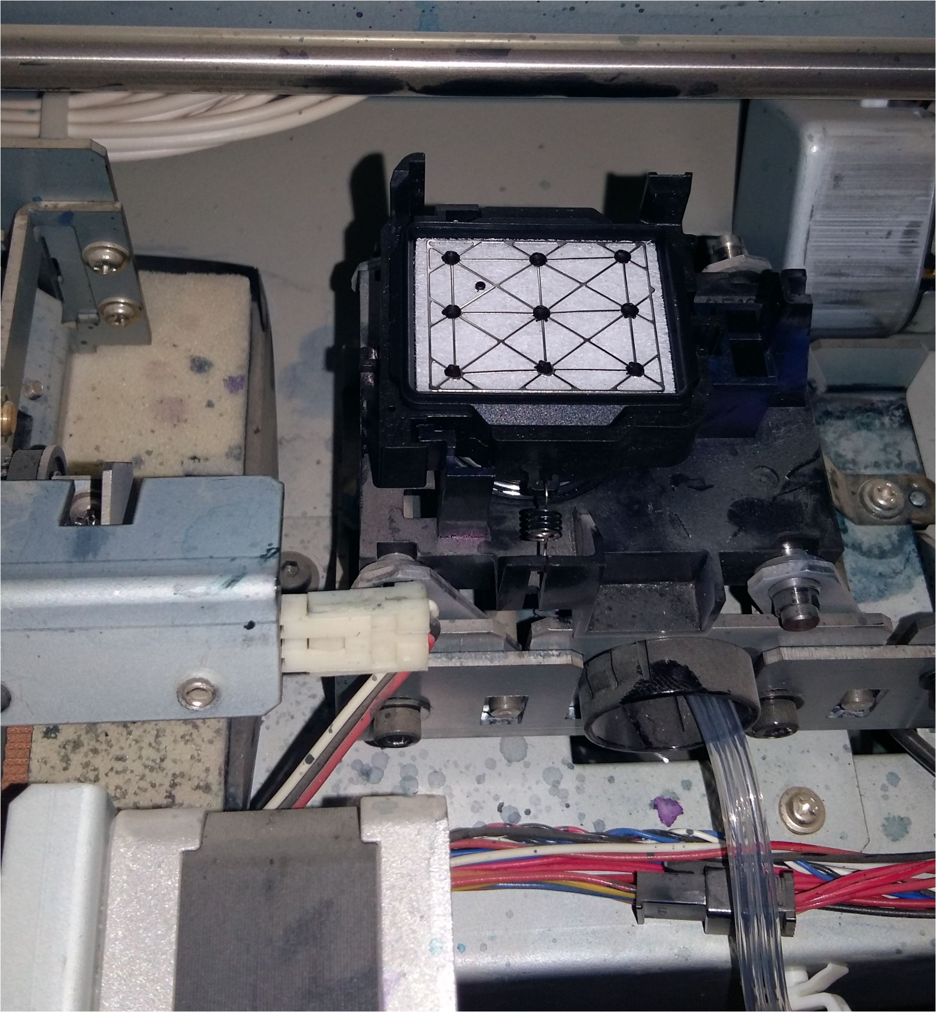

  • Salman Aziz
    September 9, 2015 at 4:39 am
    any body tried ……

  • Kevin Flowers
    September 9, 2015 at 11:46 am
    Hi as said you need to check with a syringe that the capping station is sealing and allowing a vacuum to be formed, fitting a new cap does not guarantee this,
    Kev
