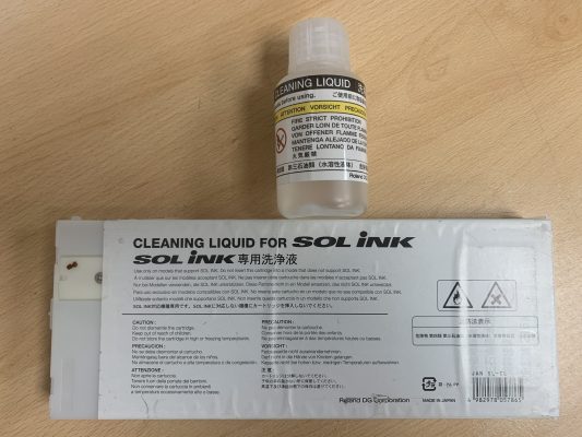

    Hi all, im soon going to run out of the cleaning liquid i use for cleaning the heads in my Roland VP300 printer. I do have two small cartridges of cleaning liquid which came with the printer years ago and have never been used as far as im aware (possibly when it was set up?). My question is could i break into one of the cartridges and used the fluid, is it the same stuff? Only asking as it seems daft to pay for a 500ml bottle when i have these lying around. Another question is what exactly is the cleaning liquid? Is it just Isopropyl alcohol or similar?

    Yes the cleaning fluid in the cartridges is the same stuff. It’s the solvent used in the inks but without the pigments added

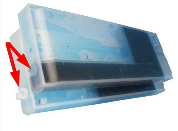

    Does anyone have any idea how to open the cartridge without busting the bag containing the liquid?

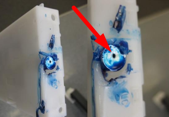

    It has been so long since we had our Roland machines. is there not a syringe with a pin on the end, rather than a needle as such? You could just push that into the hole that the machine pin penetrates, on the cart, and pull back on the syringe to extract the fluid.

    Hi Jean, from memory those cartridges are hinged and open up quite easy after running a small knife round the seam at the edge through the sticker. It’s just a matter then of prying it open then to get to the bag inside. Snip a corner off it and pour it into your old bottle. Job done 🙂
