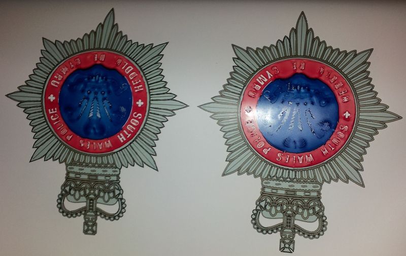

    The image printed fine on a standard gloss vinyl and I thought it would print fine on garment vinyl – Magictouch MT107. Xpres had already setup a profile for the garment vinyl, from memory the only change was the cut pressure.
    So, I load the Magictouch MT107 and print as I normally would. This was the result = a mess!
    Anyone got a solution or any suggestions?

    December 2, 2012 at 9:58 pm
    Hi Chris
    Magictouch MT107 is a garment flex to be heatpressed onto garments.
    When I purchased the BN-20 from Xpres it was supplied as part of the package so should be compatible. The guy from Xpres created a medi profile for it and that’s what I used with horrible results. It looks like far to much ink flooding/pooling on the media.
    I printed the CMYK not metallic.
  • Chris Wool
    December 2, 2012 at 10:07 pm
    if its a smooth semi gloss media bet the vinyl3 will be fine. give it a quick go
    December 3, 2012 at 7:33 am
    I had a smiliar issue with a different media.
    I was advised to increase the heater temperature. Print at high quality in omni directional, full width scan – i’ve a 64" printer though.
    Should give the ink more time to dry before putting the next pass down and prevent pooling.

  • Peter Munday
    December 3, 2012 at 2:40 pm
    I also find that printing on the right side helps……… Got just that same result by putting the material in the wrong way and printing 5 meters before going back in the print room and finding out.
