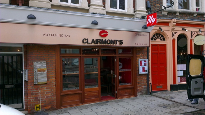

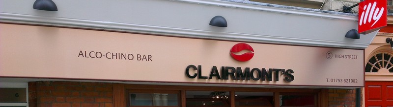

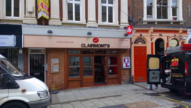

    Hi all just another sign which I really like, brushed copper sheet face fixed with brown trim, 19mm letters painted and sealed edges on locators with matt vinyl and etch to windows

    lovely job Rich…you are the man
    The copper backing looks superb where do you get that from out of interest?

    Martin the copper sheet is alupanel, this looks truly amazing in the flesh! Simple sign and for cost reasons face fixed but the trim matches the doors and surrounding area, very nice shop.

    Don’t think I have seen it used externally before, did you bond it to the existing fascia or screw it under the frame.
    Looks truely amazing mate..well done

    Fixed to edge of sheet and the trim covers the fixings.

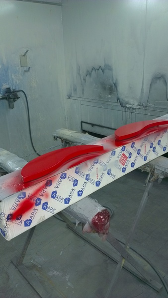

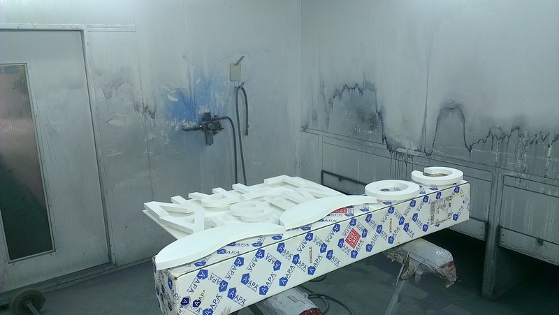

    Great work Richard – well done.
    I see your spray painting experience gained in another life is still being put to good use 😀

    Phill its been a handy skill to have mastered, so many things in this game call for time in the oven and with this weather I was painting at 30 degrees in my shorts, could not put these on a full bake as the air inside the letters would have popped on the edges so just painted at 30 and left over night.
