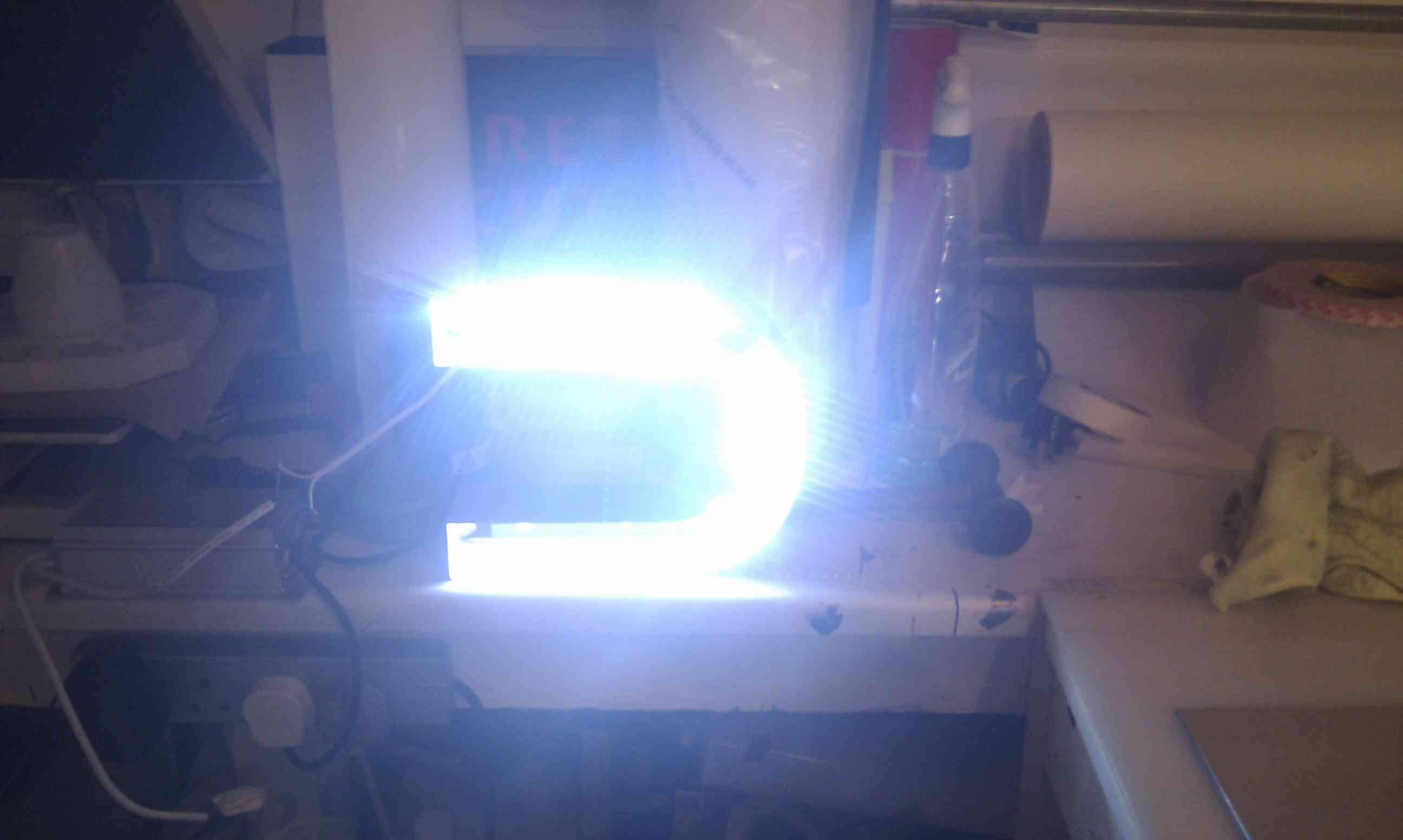

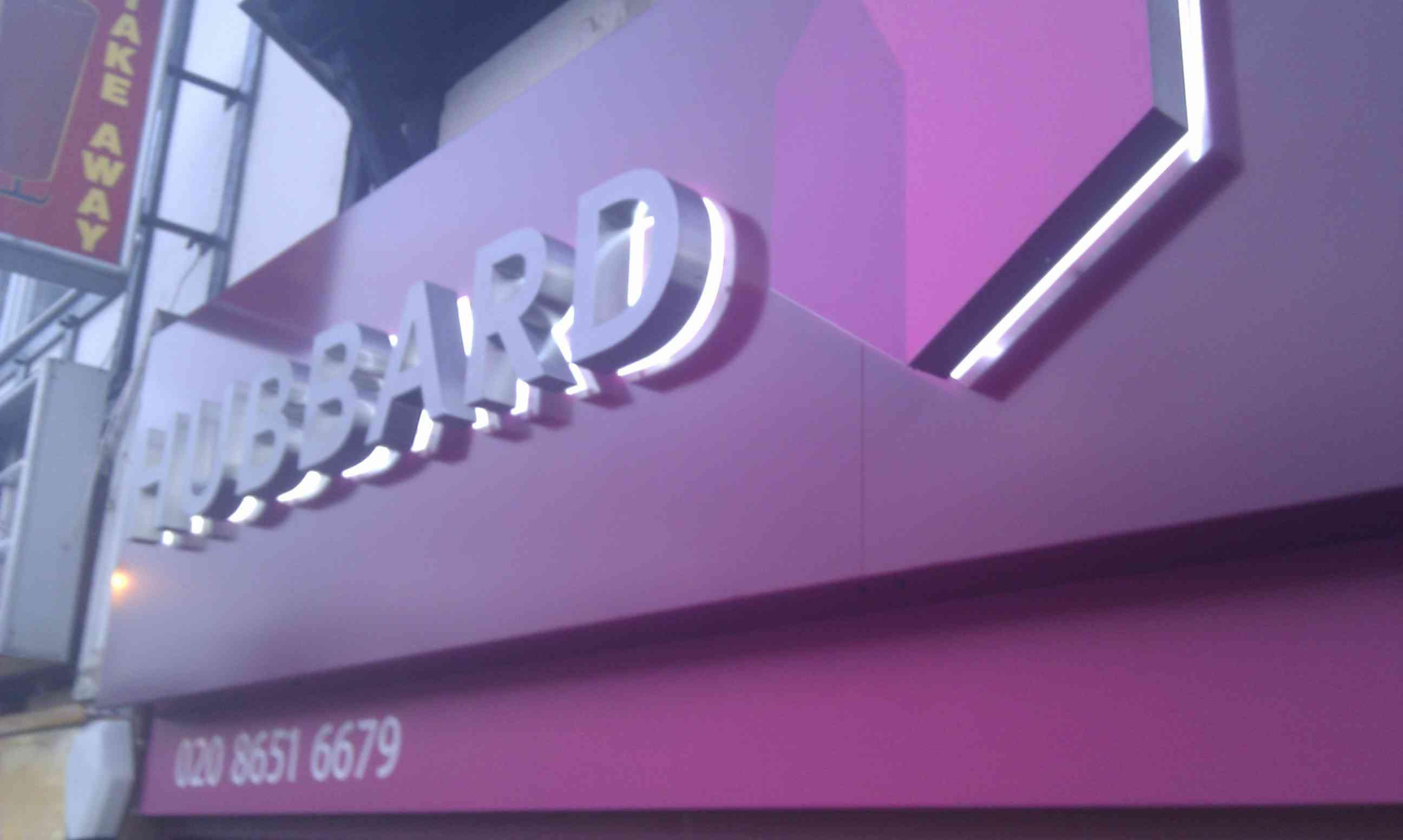

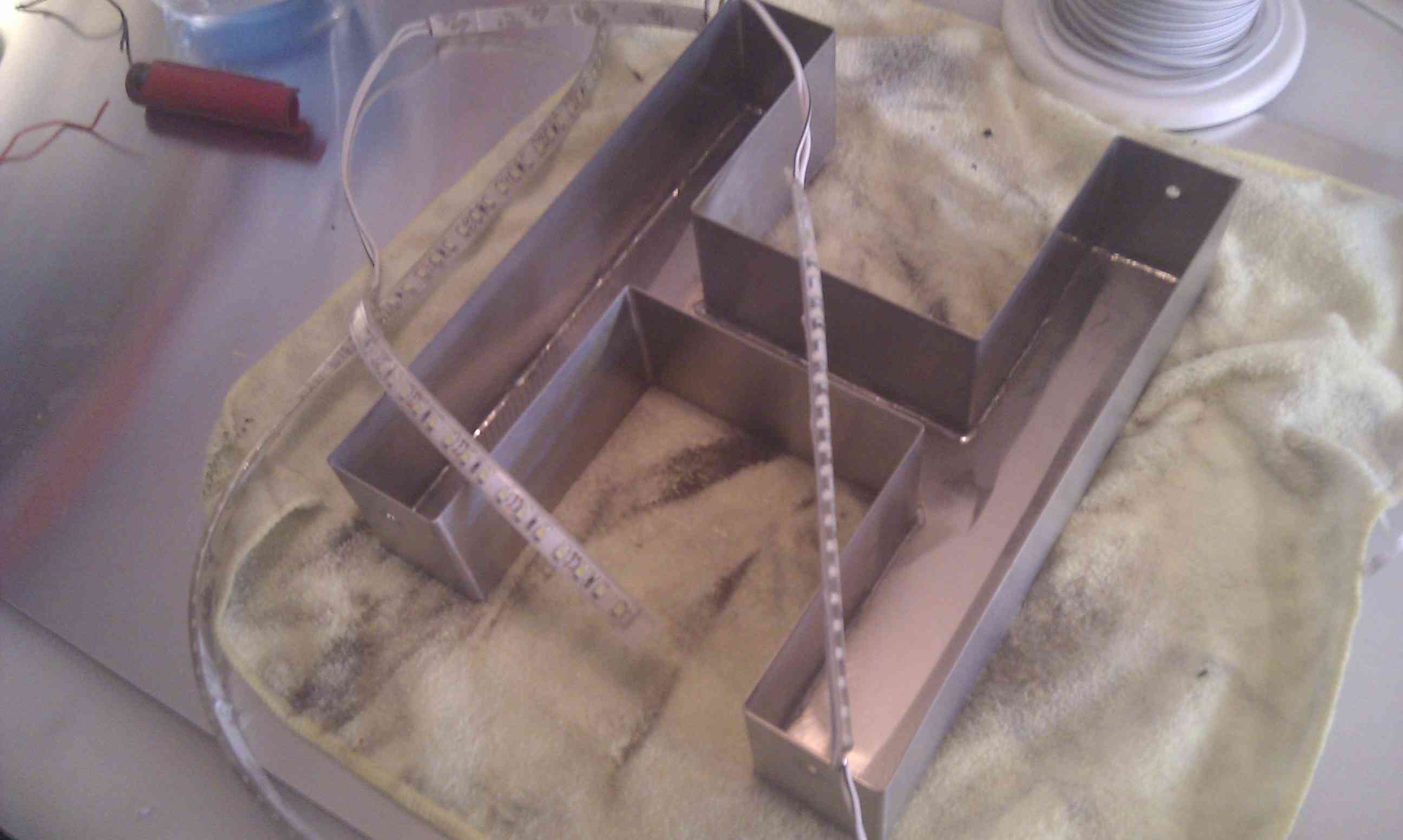

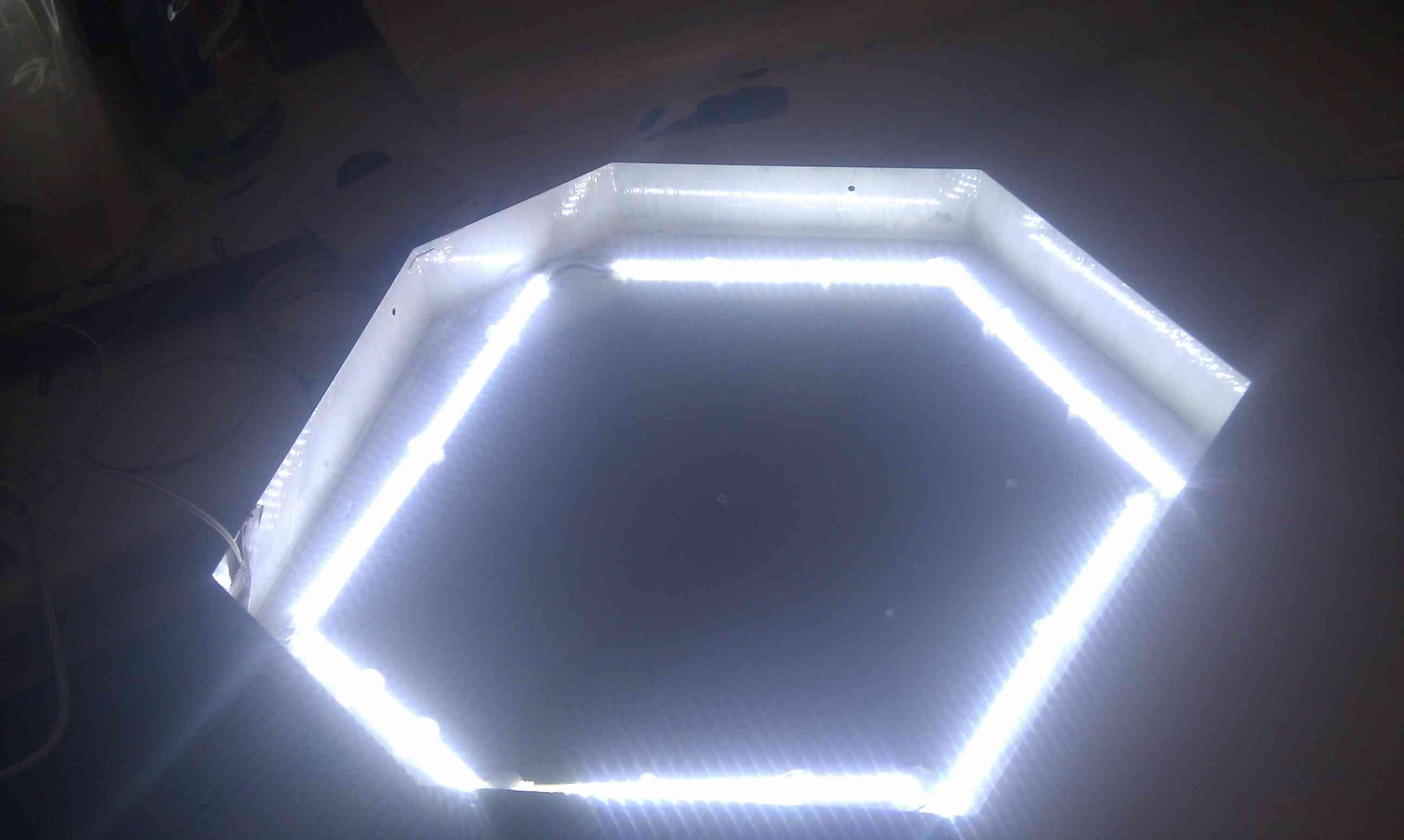

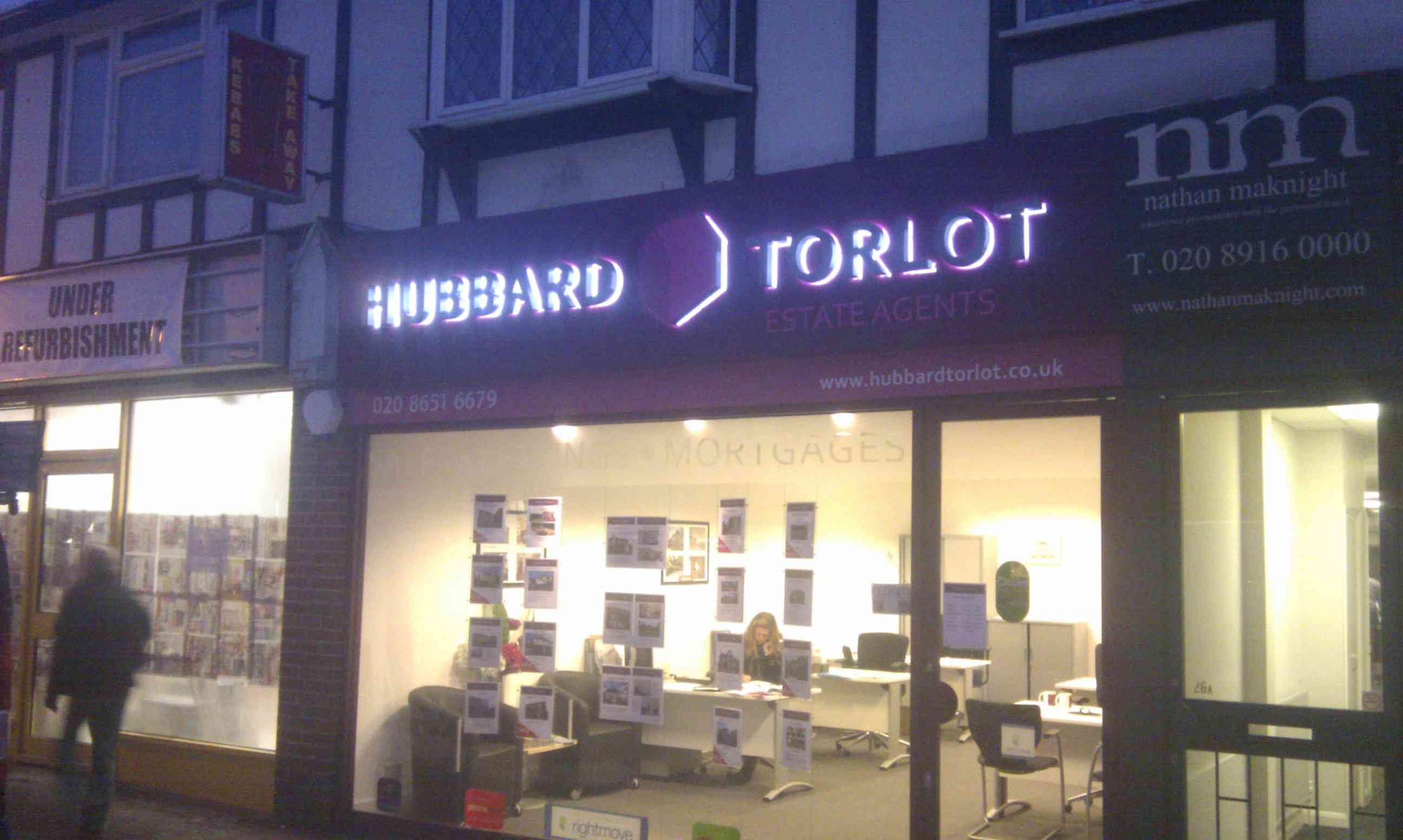

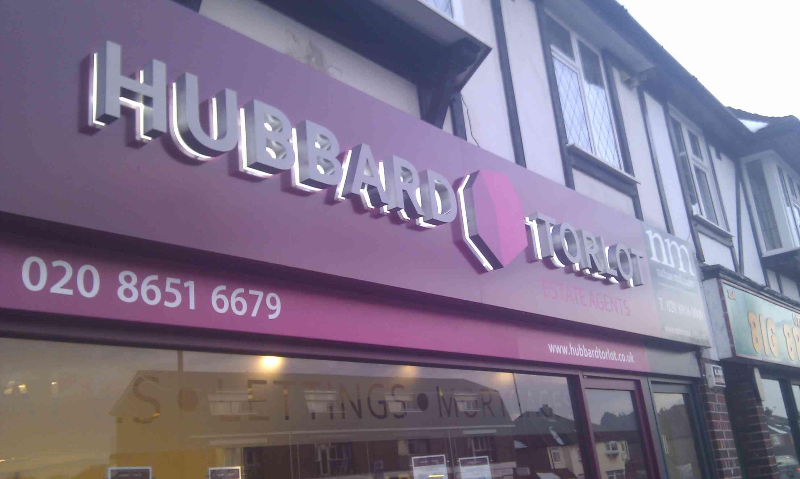

    Been busy and have loads of work to post up but don’t find much free time these days, built up lettering on poly backs, fitted with L.E.D on a roll, cut and soldered to size in each letter, aluminium sign trays powder coated to RAL colour. Rich

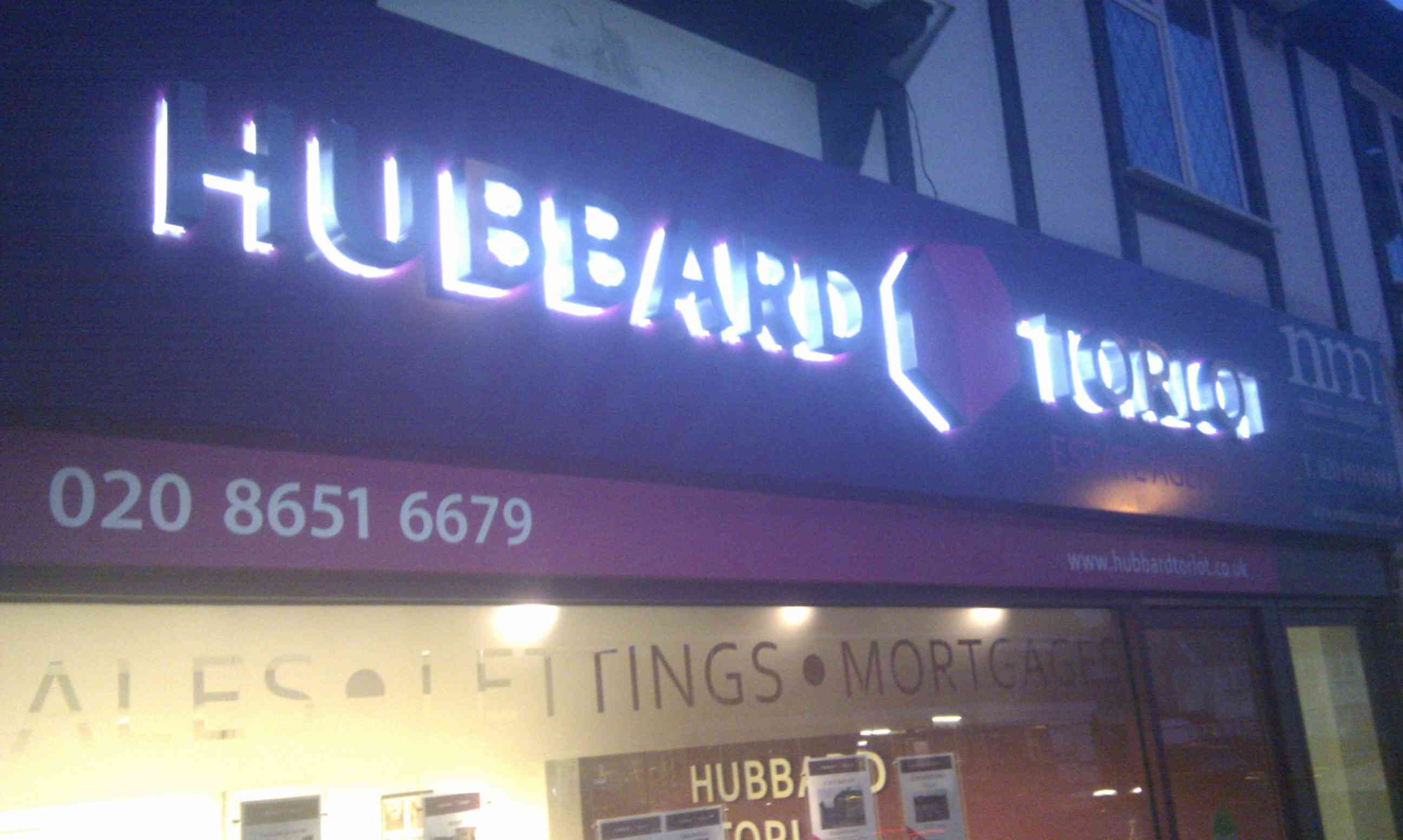

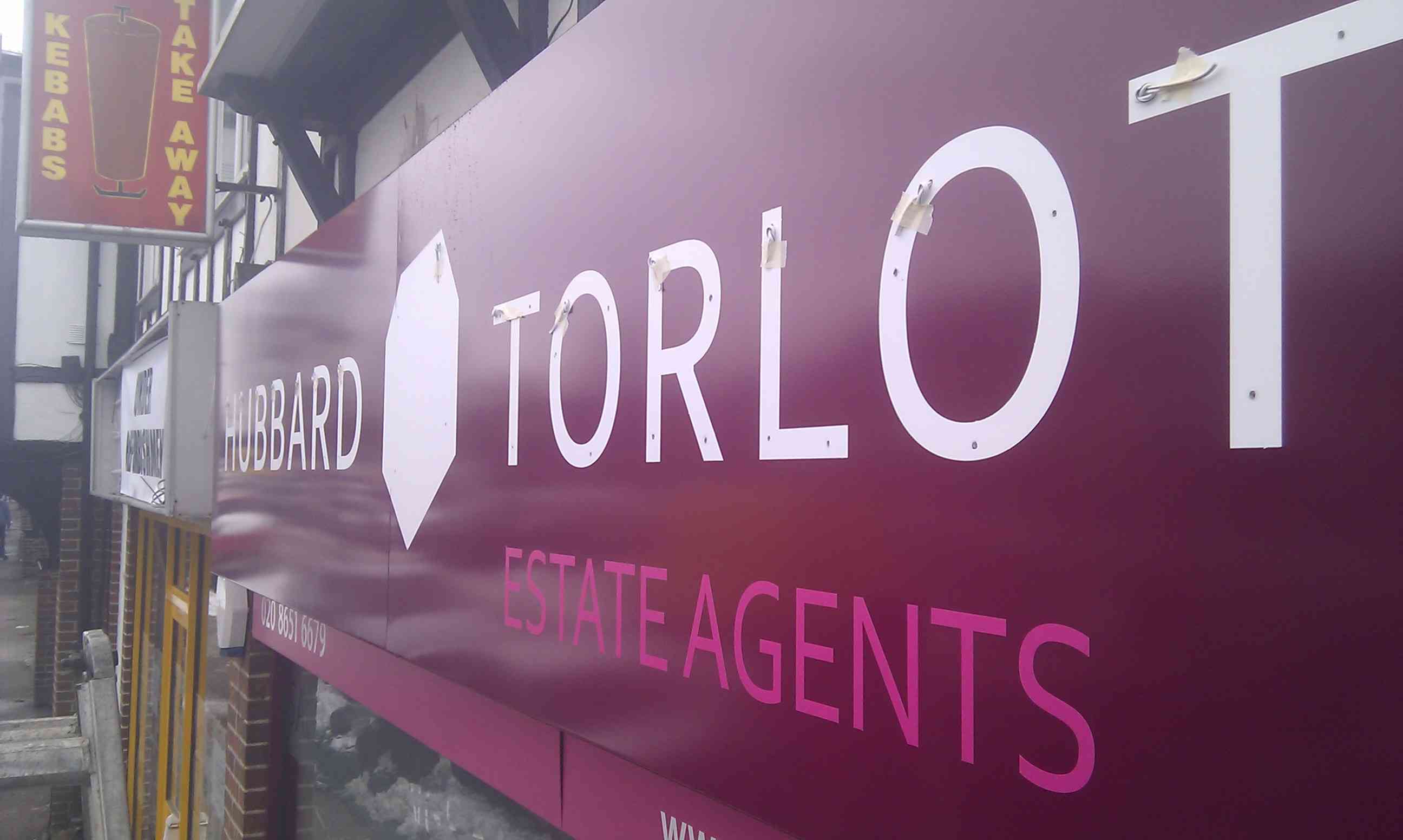

    Peter not sure if you can see but we also made a sign tray for the green sign on the right of this, so may be we will be asked to do next door, think its a food shop so will want it done for free kebabs!!

    Thanks Chris, the leds are nice but lots of work to cut and strip as these are the waterproof ones. I like this type of work and enjoyed making this sign. Rich

    Thanks Rob, the L.E.Ds were ribbon type fully waterproof, cut to size and each joint soldered to printed circuit. They were brought from a well known company just before they sold to another well known company. I like the effect and smooth glow but I have to admit it was so time consuming creating each letter due to the amount of stripping of the ribbon type L.E.D .
