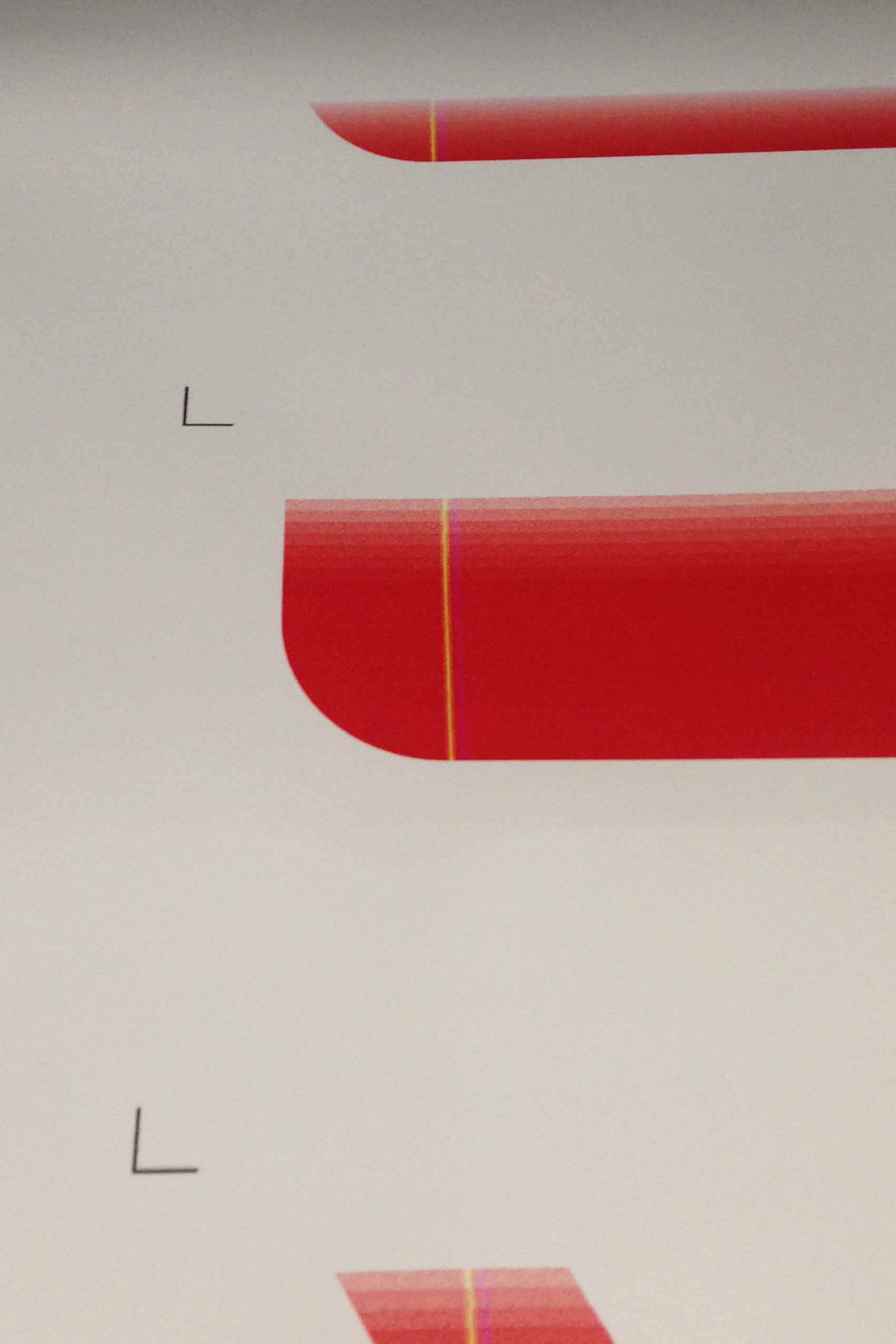

    I think i have a problem with my encoder strip, can you take a look at the pic please and let me know what you think please
  • Graeme Dingwall
    December 10, 2013 at 3:43 pm
    It looks like it’s the encoder i have just had the same problem.
    Try giving it a wipe gently with a wet cloth.
    If the worst come to the worst you can turn it upside down and it will work.

  • Stafford Cox
    December 10, 2013 at 8:46 pm
    Yep, I’d say encoder strip too. Print it again and look at the encoder strip in line with the fault on the print and you’ll probably find there’s some crap stuck to it. Clean it with IPA and NOT head cleaning solution or all the markers will come off. And turning it upside down definitely works. Much like turning your underpants inside out 😮 (apparently)
    Stafford :lol1:
  • Dermot Howard
    December 19, 2013 at 10:40 am
    HI Guys.
    Thanks for your help. I cleaned it and its working perfect now.
    Thanks again
