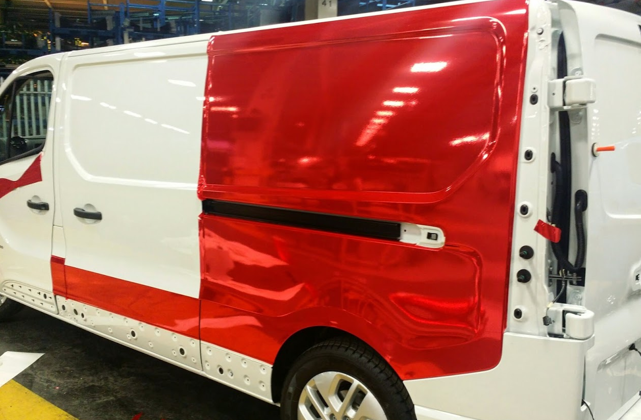

    an old one i have pictured that has them removed. no tape.
    removed rear corner panel also. all hex-head bolts and clips.

    lol, aren’t you supposed to be sunbathing! Cheers mate, suspected would be same but thought I better check, full wrap including roof coming up next week, :thumbsup: out of interest I take it you wrapped the side trims on that job, how difficult did you find them?
    January 9, 2018 at 11:02 pm
    was a while ago now for this one and as you see its in chrome red, so does not conform as well as a regular solid colour would but was pretty easy. i think two of the side parts "at one end" Will fold in on itself but in doing so requires a corner or two to be slit to allow the fold to be made all the way. yes you could stretch over this corner but if its a print it will whiten, if it was me with the red chrome, that too would show stress marks/whitening on the vinyl. so the half inch slit which is completely hidden when side slit doors are closed was of no issue at all.
