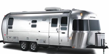

    August 8, 2012 at 7:26 pm
    Cheers Rob
    It’s on one of these,
    May have to get some strips of foam and tape over the glue because lots of it 🙁
