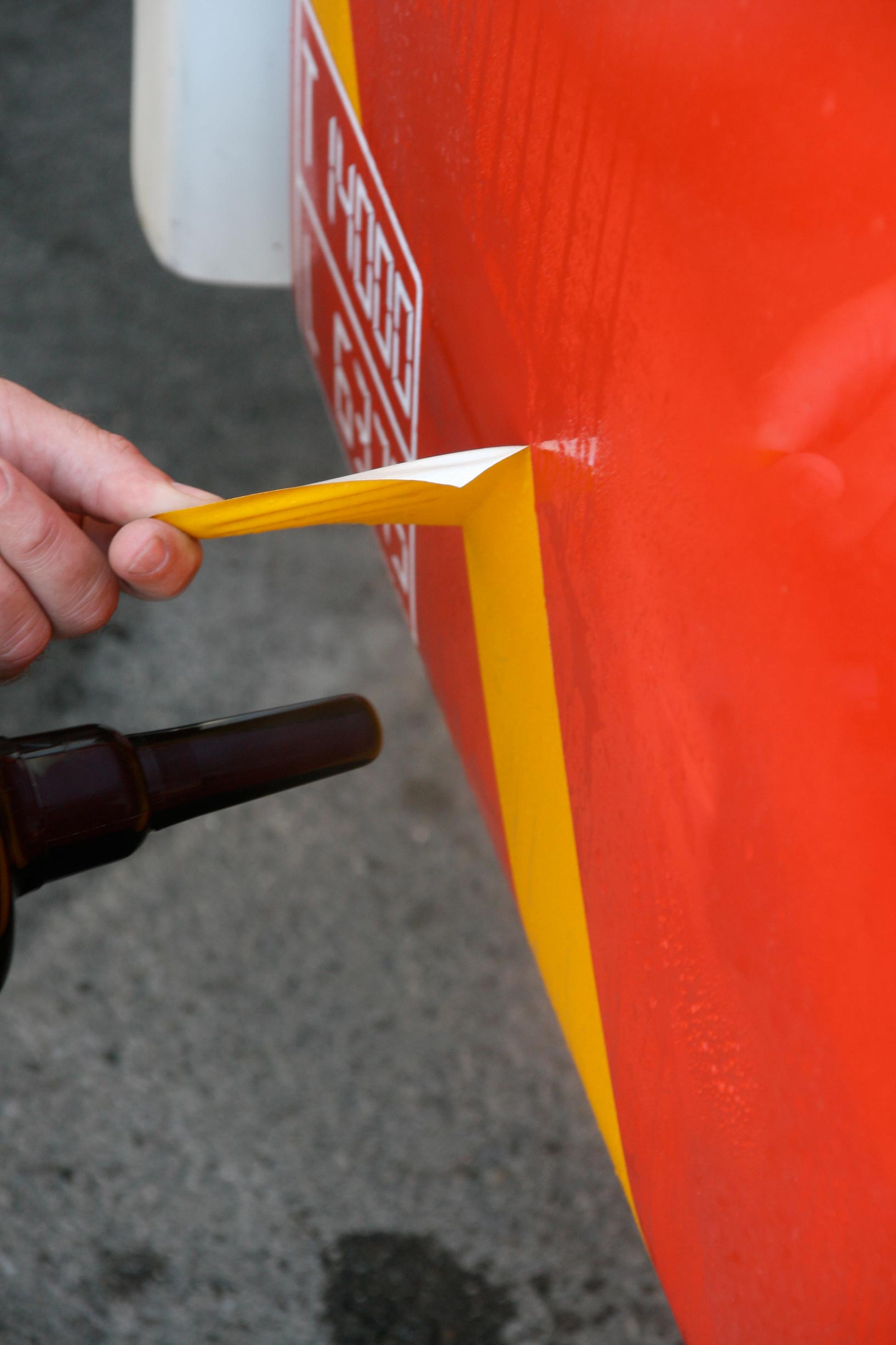

    Hi this stuff is a real pig to remove whatever grade. I do repairs to a lot of fire engines and this is what i do to remove it. I use a scalpel to lift an edge push it in as far as it will go. do a few times next to each other, Then get a metal ruler and push and wiggle it as much as you can it should lift it in small sections (big if your lucky) but i seems to work without leaving the white behind. Once done clean with siprit to remove any little patches of glue. Its a long process but if it has to be done then this is how i do it

    I would have thought that applying a little heat while doing this would help.

    heating the vinyl softens it, but try heating the vehicles panel instead. there is a difference. wave the heat gun over an area of about 16 inch. keep the gun moving quick so as not to scorch the panel. let it heat till the pnal is as hot as a piping cup of coffee… then use a stiff nylon squeegee or a lil’chizler which Jag supplies do and at an angle, not flat on… cut into the vinyl and it will slide off leaving no marks to the paint work. you then need to contend with the adhesive residue.

    Hi Natasha, steam is sometime a good solution. Gets reflex off in one piece, but can be timeconsuming.

    We have had to remove lots of reflective for a decommisioning job a while back and by far the easiest way to remove is with a steam wallpaper stripper, simply hold the end to the vinyl for say 15-20 seconds then pull the vinyl off at an acute angle, this usually removes all the glue too.
