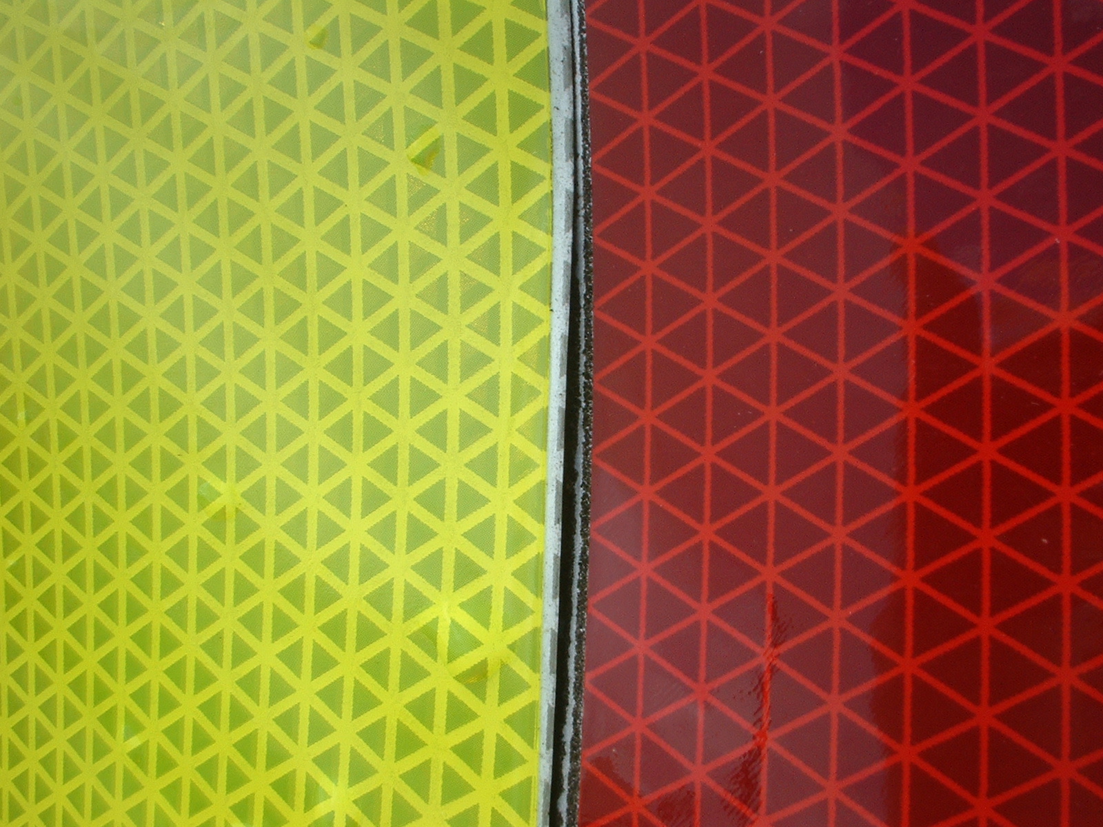

    Can anyone help in letting me know where I can buy Reflexite reflective material for emergency vehicles?
    Have a job to match up and I think its this material, but dont know where to get it from… also how much is it a meter?
    I’ve attached a photo of the profile of the material

    That is Reflexite vc312. It’s about 60 squids a metre and they usually make you buy 50 metres at a time. Perhaps you could try someone like PVL ( http://www.pvluk.com ) and see if they will sell you a shorter amount.
    Incidently, you can’t cut it with a normal plotter. At least, not easily.

    Apparently this material is lazer cut to seal the edges, nightmare on a plotter as the top clear edges tend to peel away if caught.

    thanks for all your help.. got it from Hexis in the end… the colours match perfrectly aswell…
    Reflexite doesnt need edge sealing… so its easier to work with.
    Not using a plotter to cut it.. good old scissors and a knife for this job.
