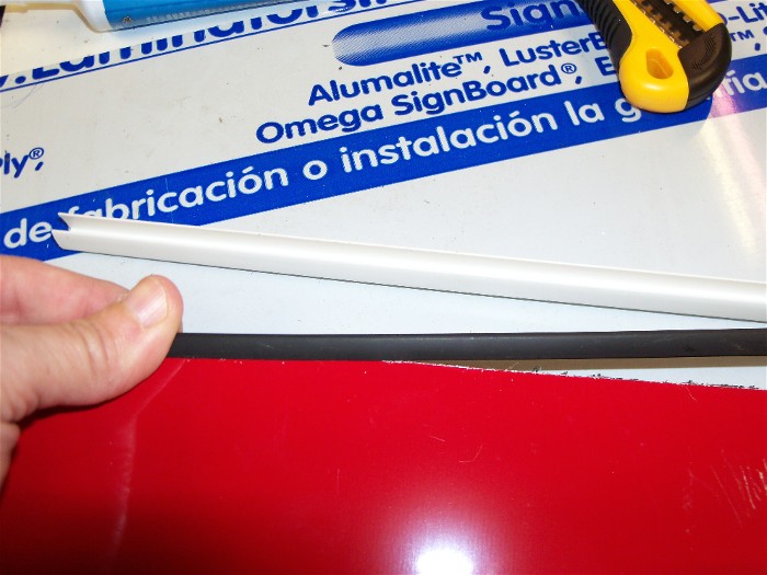

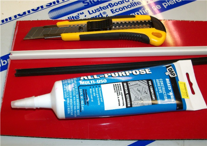

    August 24, 2010 at 5:03 pm
    Liam these are the tools I use (snap off Xacto knife)
    adhesive and my hands.
    You can heat and bend this stuff too but I never tried it.
    You can cut the edges to 45° at the corners.
    The black stuff is the edge cap from Alumalite.
    The white stuff is the edge cap I get via my supplier N Glantz and son.
    I prefer using it, as it’s a deeper channel.
    But it only comes in black and white.
    The Laminators Inc. edge cap comes in colors to match their Alumalite.
    If I can use this stuff even a chimp could do it.
  • Liam Pattison
    August 24, 2010 at 7:20 pm
    Thanks Steve and Stephen for the info, all the sites people have shown me, i have found other good stuff there as well, so thanks.
    Jill thanks very much for the tutorial and pics, that’s exactly the help i was after. Just wanted to make sure i had it right in my head how the edging worked and looked, may seem simple to some, but just wanted to double check it!
    thanks for taking the time to upload the pics,
    Liam
