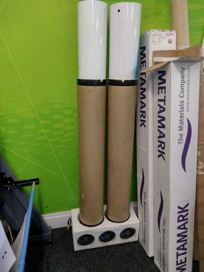

    Again, contrary to what you will have been told. outgassing with the vinyl on its end is not the best method for outgassing. doing it this way actually trapped the solvent in several different ways. I know you have been successfully doing this in the past, but even then it isn’t the best, it’s just the easiest!

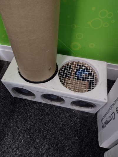

    7 December 2021 at 13:28
    Sorry Robert should have stated they were on my DIY drying unit. The job we’re working on at the minute was printed on the 30th Nov and was laminated yesterday. It’s been sitting with the fans drawing out the gasses since then! It is a heavy saturated black but surely 6 days to dry is a joke. We’d spoken about a clothes dryer like you mentioned, just getting space for it is a problem here, need a bigger unit (again)!
