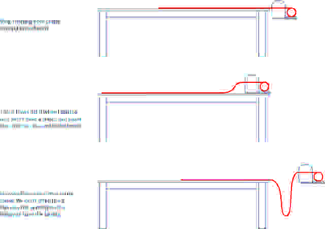

  • John Childs
    March 6, 2010 at 11:02 am
    This is what I meant Harry. No second bench anywhere.
    Added on edit: Oh, bugger. Can’t read the words. Oh wellโ€ฆ…
    The top one is what I think we are discussing.
    Middle is the way I did it when I started, with cutter sitting on the end of the bench.
    Bottom is the way we have one of our cutters set up today. Not too often used like that, but can be very useful sometimes.

    john we used to have same sorta setup some time ago. although it does work. when the machine is cutting large jobs, jumping back and forward the bench often caused problems. i.e. instead of the machine lifting 3ft drop of vinyl at one time. it was trying to pull back vinyl that’s slid the length of the table. or if it stacks itself in from of the mouth of the machine and tried whizzing back to its origin point, it somtimes jammed the machine as the motor is trying to pull the stacked pile of vinyl.
    as you said, i cant read the text on your illustration, so excuse me if theres something mentioned there about preventing this.
    to be honest, when i look back at it when we had it, i didnt/dont see the point anymore. the guy weeding or working is limited in what he can do because the vinyl is still attached to the machine. worse still if the job is midway running.
