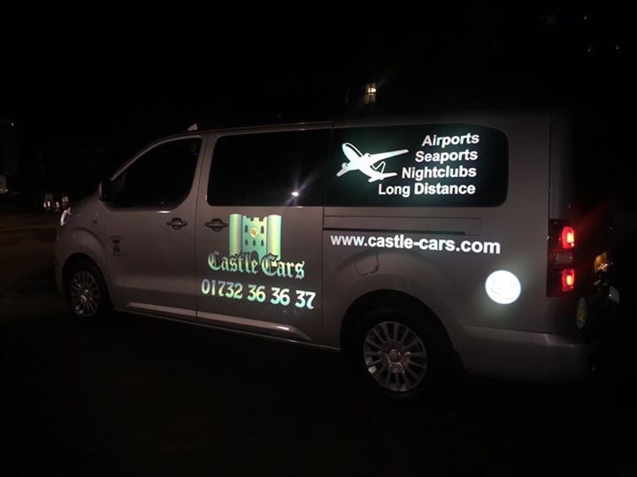

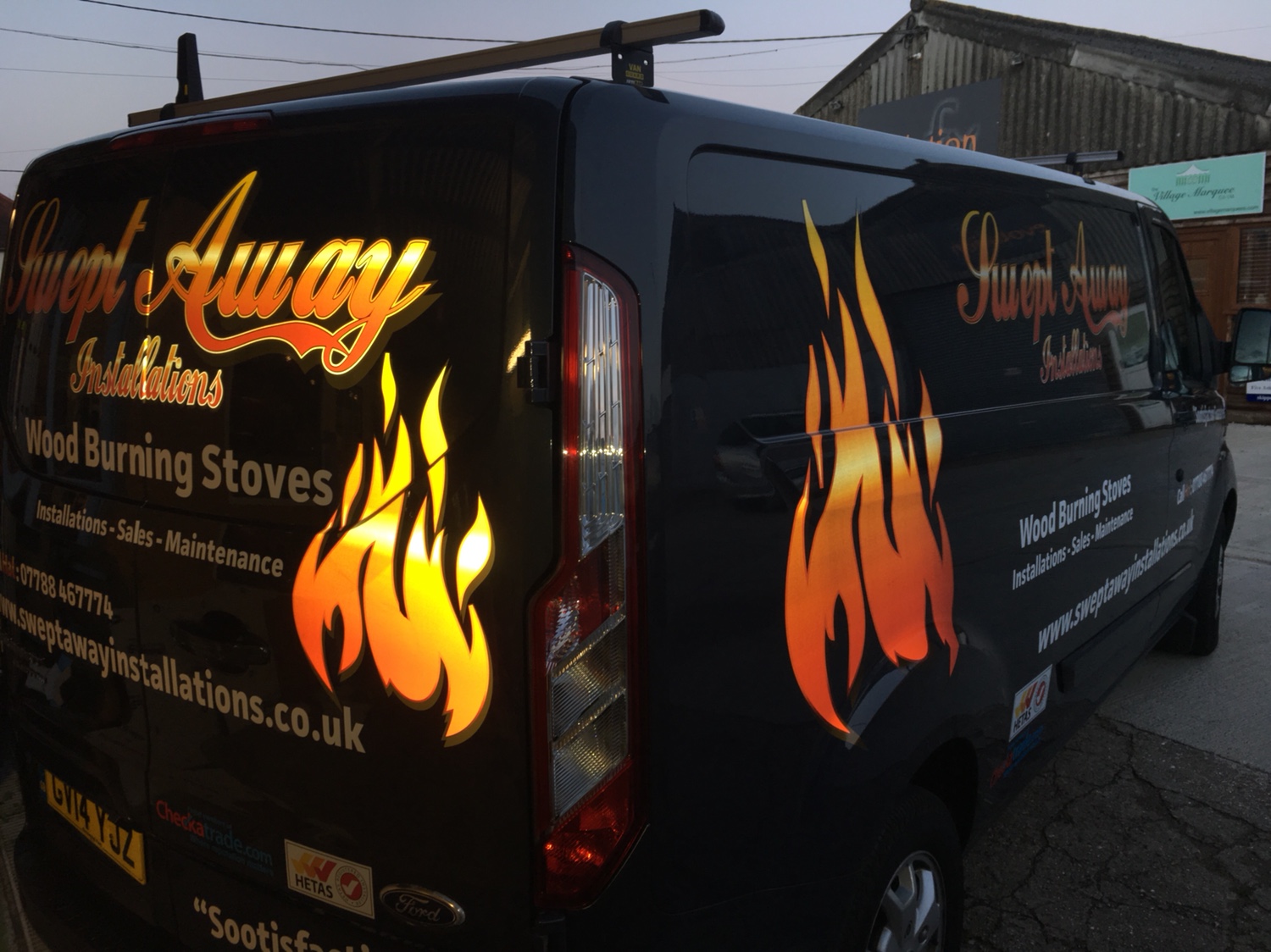

    I also make my own ad boards in indoor arenas reflective – spectator uses a flash and boom, there’s my board in the background while others are dark!!
    A few examples..

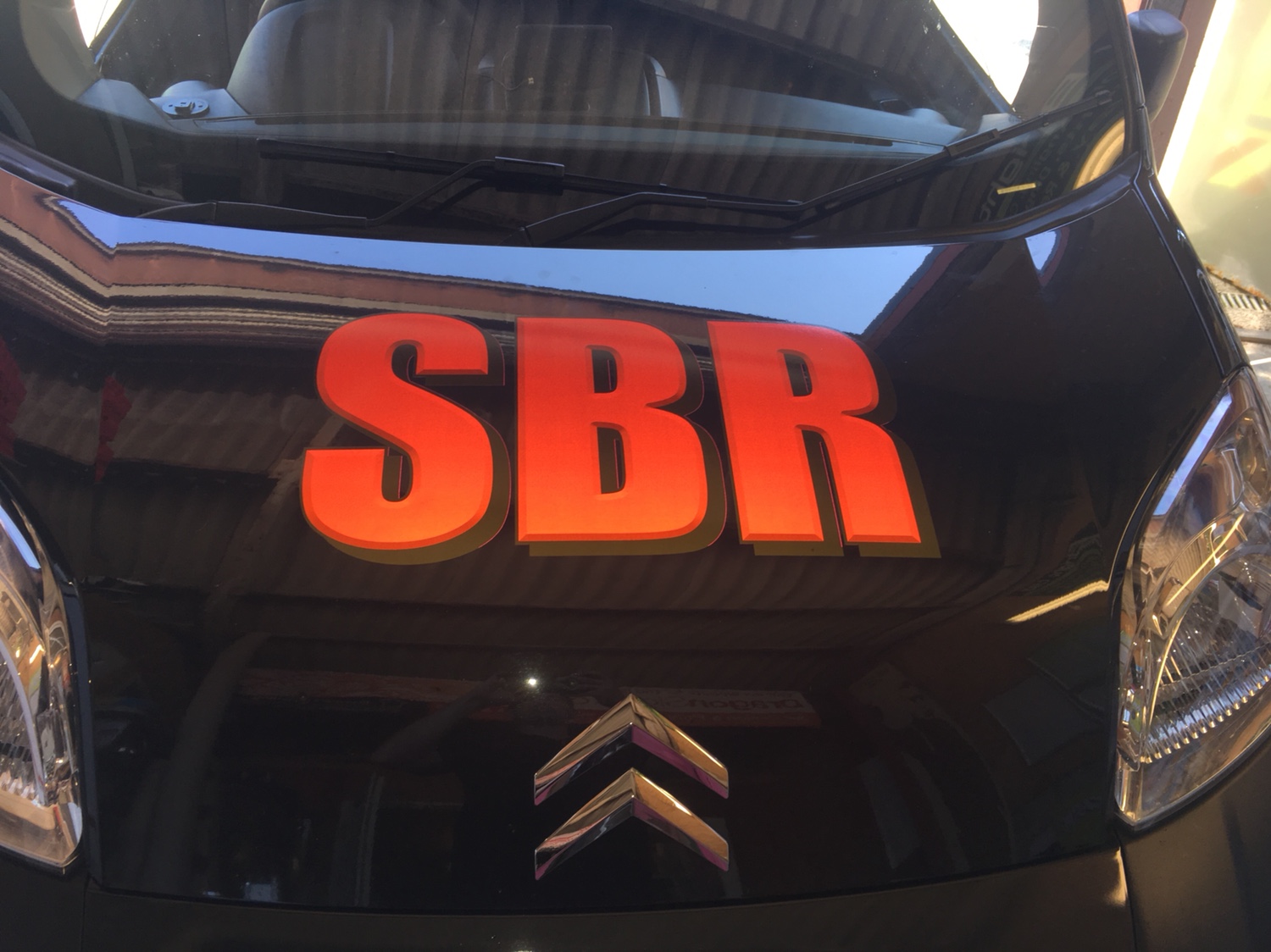

    Just seen your other post Myles.. 100% magenta on oralite 5400..
    Not as dark as it looks in the first photo.
    Wow!! that’s quite impressive how well the reflective comes through. Especially following the comment from a supplier earlier saying that ink on reflective stops the reflection!!! It did seem to defeat the purpose of printable reflective! :bangshead:

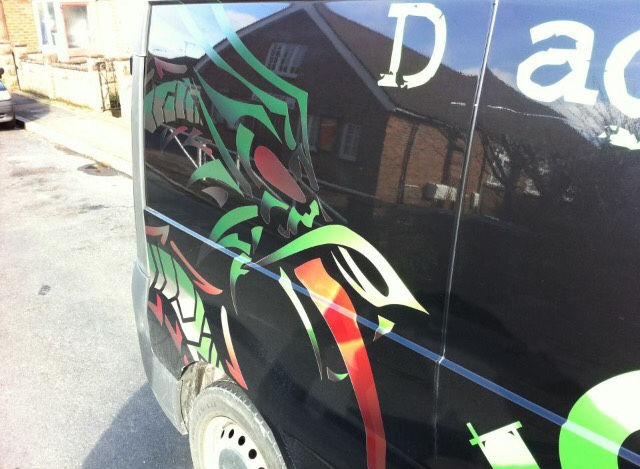

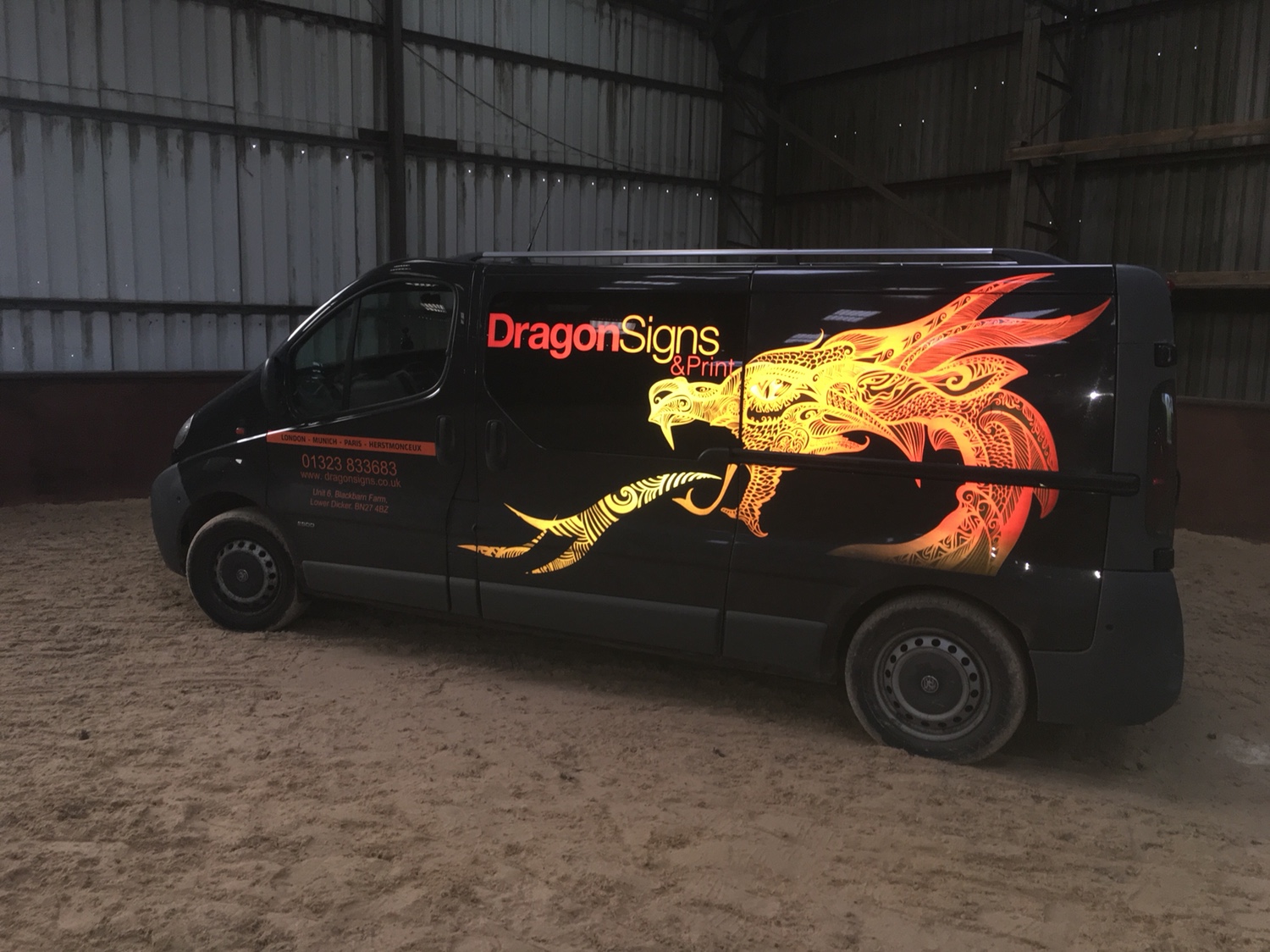

    Love the look of your van. Is the black in the dragon printed or is it contour cut?
    March 27, 2018 at 7:54 pm
    Printed, bugger contouring all that [emoji23]

    Simply.. yes, I did it on a previous van layout, reg marks are the hard bit! If I recall.. a weed box and cut file were made, then manually sent to cut using the corner of the weed box as a start point.. long time ago now and a colleague printed it for me!
    Black reflective reflects a whitish light so colours are illuminated when the film is..
    The illuminated photo here is lit only with the sun behind me when I took the pic, better at night, more holographic looking by day. They won’t be totally invisible as colours will still be seen to some degree.

    Justin,
    The black would illuminate to a degree but not to the extent that the red / yellow would.
    See the photo of my van, that’s printed on reflective white, the black areas are printed and don’t light up much at all.
