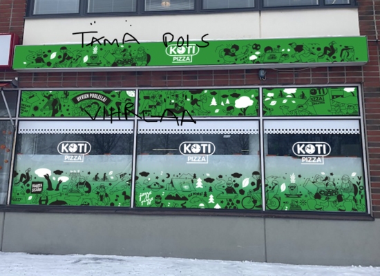

Posted by Martyn on March 28, 2023 at 2:29 pmHi folks.
I received some artwork today for a shop that I am doing. I’m yet to speak to the designer but the main windows have a fade to them without a background at the top so printing onto standard vinyl is out of the question. I’m putting my bets on it being frosted (as other shops have a plain frosted band at the bottom) which brings me to a few questions I’m hoping you can help with:
* Ive never fitted printed frosted outside before, what is the best lam to use? Matte, I assume.
* Should it be optically clear or does it not matter
Also, the artwork has white in it which is a huge problem as I can’t print it so the only way around this I see is laying the white in vinyl over the top which A is a pain and B I don’t know how it would look.

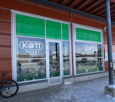

Hi Martyn
This is purely guesswork because I can only do this from your photo of the windows, mate.
Am I correct, that you are saying these graphics should be fitted “outside” onto the glass?
If so, I would use Gloss laminate, because the window surface is gloss. If you do not, then the top section that has no graphics will be shiny glass, but the lower section with the prints will be matt. If that make sense? I would keep it all consistent.I also “think” the windows might NOT be glass etch vinyl.
They look like they could be entirely printed in green blending out to an almost white mint finish, which is printed onto clear vinyl and laminated. as I say, “I am guessing” but This would also allow for those white sections to be done in the same print pass.
Furthermore, the colours Green, black and white, look pretty strong. when printing to glass etch vinyl, the colours normally look more washed out and semi-transparent.Again, if the lower section is all a print, fitted outside. then the actual white “logo” could easily be fitted on top in cut white vinyl, after the prints are applied.
I am completely guessing from the photos though mate. -

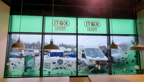

Thanks for your feedback guys.
She sent over this internal picture of one that has been done. She said that the shops are all done slightly different altho they should all be the same.
So lower part is either printed frosted or clear lam and im not sure about the top part.

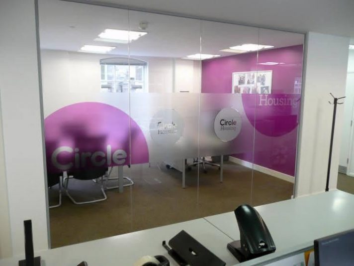

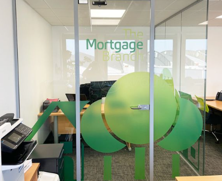

Rob those 2 examples you posted look like frosted? not clear?

Your last photo looks print on clear. Colours look washed.
The vans are showing up.
I will guess gloss laminate, because matt will make a frost / matt-ish finish and the vehicle will not be showing as much.
Judging from your first photo. If you can, offer frost from the inside the shop. Rest from the outside. Stronger colours. Simplicity for the client. Frost is privacy. And they can change the outside without touching the frost.

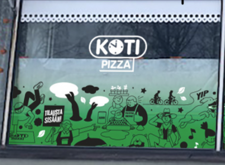

Original designer mock up is very different from final product.
Thanks pane. Yes the colours are also an issue. Their green is vibrant and looks perfect printed on normal vinyl. When you shift to clear or frosted it looks fine from inside shop but much darker outside. I just done test prints to figure this all out.
I think my suggestion is going to be frosted on the lower windows but then normal vinyl on all other windows so that their brand colours are actually met.

As said, the photo looks to be printed on a clear rather than frost but the same problems will occur.

Yes, mate. Those are frosted print examples i have posted, not clear.
My point is the frosted colours are washed out. the ones in your windows, are not, which indicates it is clear vinyl printed with a combination of white ink. which will give the colours more strength.Your updated photos confirm they are indeed using clear, because the prints are transparent, frosted is not. but in the New window photo, it is NOT white printed. without the white ink, the prints will be even more washed out, “near invisible printed images”. which I personally wouldn’t advise on. However, there are still areas of white graphics showing. so I’m still a little confused on how this was done. could simply be a combination of prints and cut vinyl.
