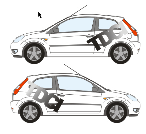

    I have a customer who’s after some large car graphics, black fading into silver.
    Could this be achieved using 751 & if so would it require laminating, I’m guessing yes?

    Hi Neil, I tried printing to white 751 a few weeks ago, couldn’t get a good print on it for some reason printed to loads of other vinyls no problems but the 751 looked like it was repelling the ink, you might have more success but I would print a test first to some to see if you have any trouble. Yes it will need laminating.

    😮 Ouch, if my pricing is right on this you’d be looking at charging the customer around £275+ surely i’m way off the mark here 😕
    Graphics would be approx 1200×900 with around 3-4 hours work time (printing,laminating,fitting)
    would really appreciate any feedback on this
