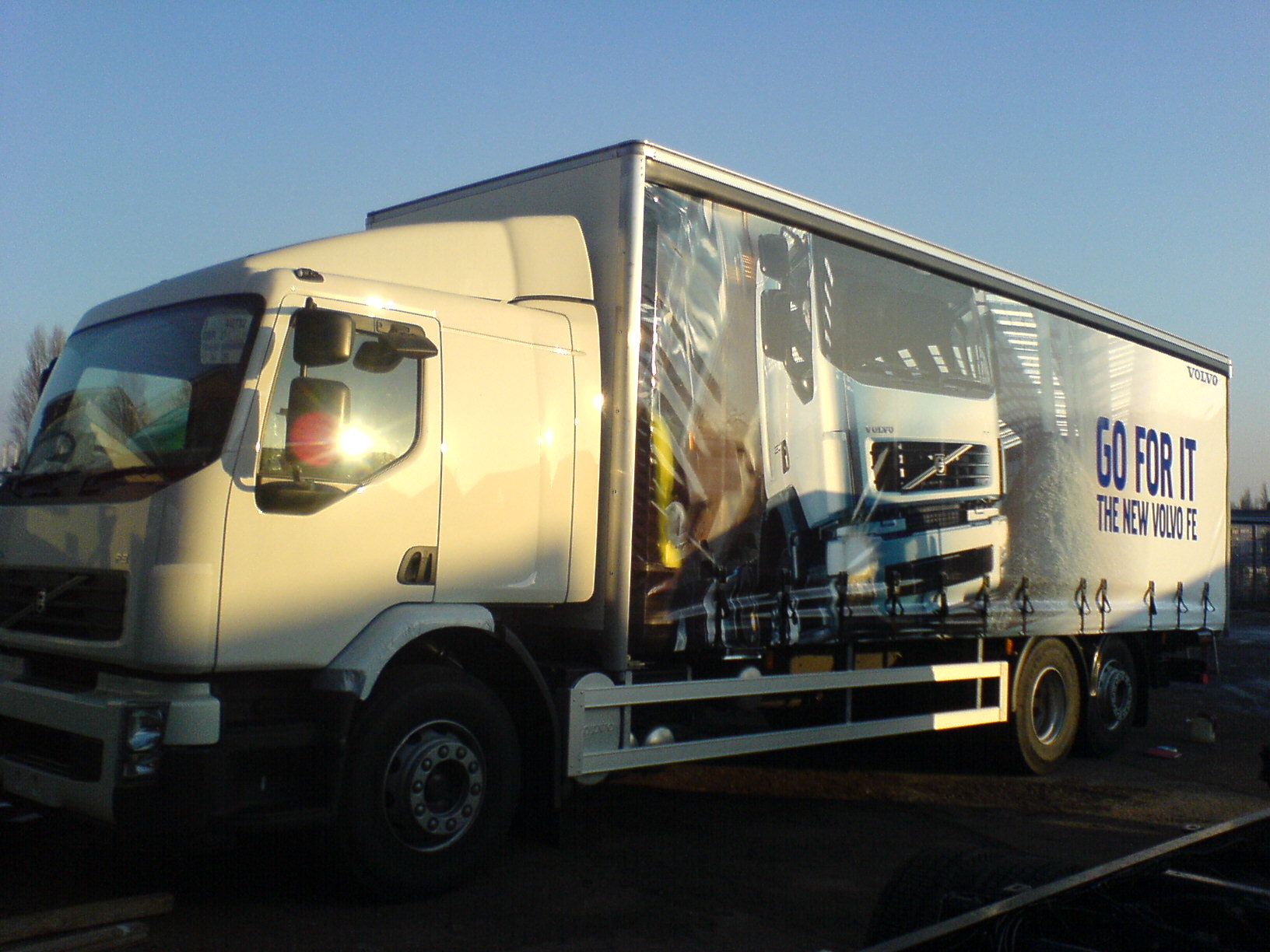

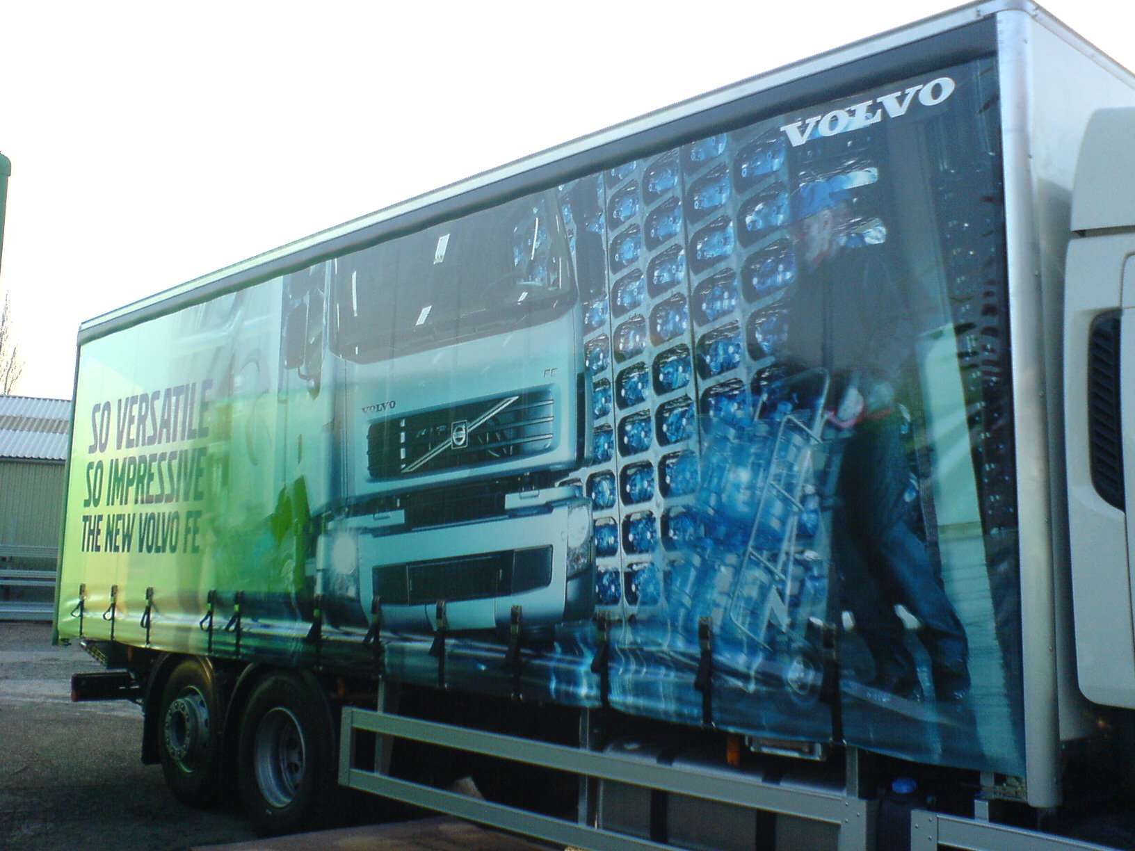

    Very nice Phil,
    Do you print the curtain material yourself and then apply the straps, hems and stitching etc?
  • Phil Halling
    December 23, 2006 at 9:56 am
    Yes
  • Graeme Speirs
    December 23, 2006 at 10:53 am
    hi phill looks good, can I ask what type /weight/brand of banner material you use for this type of work?
    thanks
    graeme
  • Phil Halling
    December 23, 2006 at 11:36 am
    We used coated truck curtain, 900 I think, printed with full solvent and liquid laminated.

    your forgetting, the visible area of the curtain is smaller than what is needed to produce it, you need a good 6-8 inches at the bottom of the print to make a proper pocketed hem where it runs against the rave bar of the truck and at least 15" each end for wrapping around the poles plus when your printing that size it’s wise to print a colour bar to ensure all heads are firing – that takes up a bit of print area as well.
