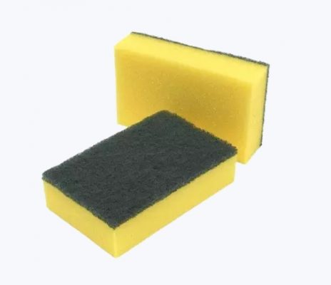

There are ways to clean the aluminium:-
* Soap and Water with a soft abrasive sponge (see picture)
* Aluminium cleaner (wear gloves)
* Whatever you use, rinse properly.
* Lastly, clean with isopropanol before applying the vinyl.3M primer:
