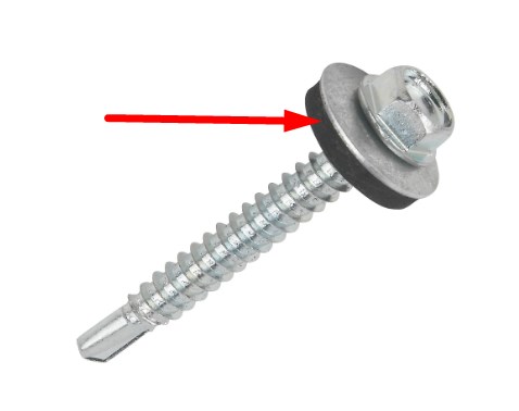

    We have done loads of this type of thing, up to 12ft by 30ft banners in the same fashion.
    I forget the proper name for these rubber back washers but you get them on tech screws as shown below.
    You can buy them separate from the likes of Screwfix.
    Use a minimum of 35-50mm screw with the rubber back washer which will hold the banner secure.
    Use a decent heavy grade banner material.
    Definitely hem the banners. And if at all concerned with the strength, use nylon hem strengthening tape around the perimeter.
    I occasionally pass banners we fitted in this way 3-4 years ago, 20ft x 10ft and still perfectly fine. they do have nylon hemming tape on them though.
    I have attached a picture of the type of screws, which you can get from any Howdens. (do not use the silver tech screws just using that to show the washer)
