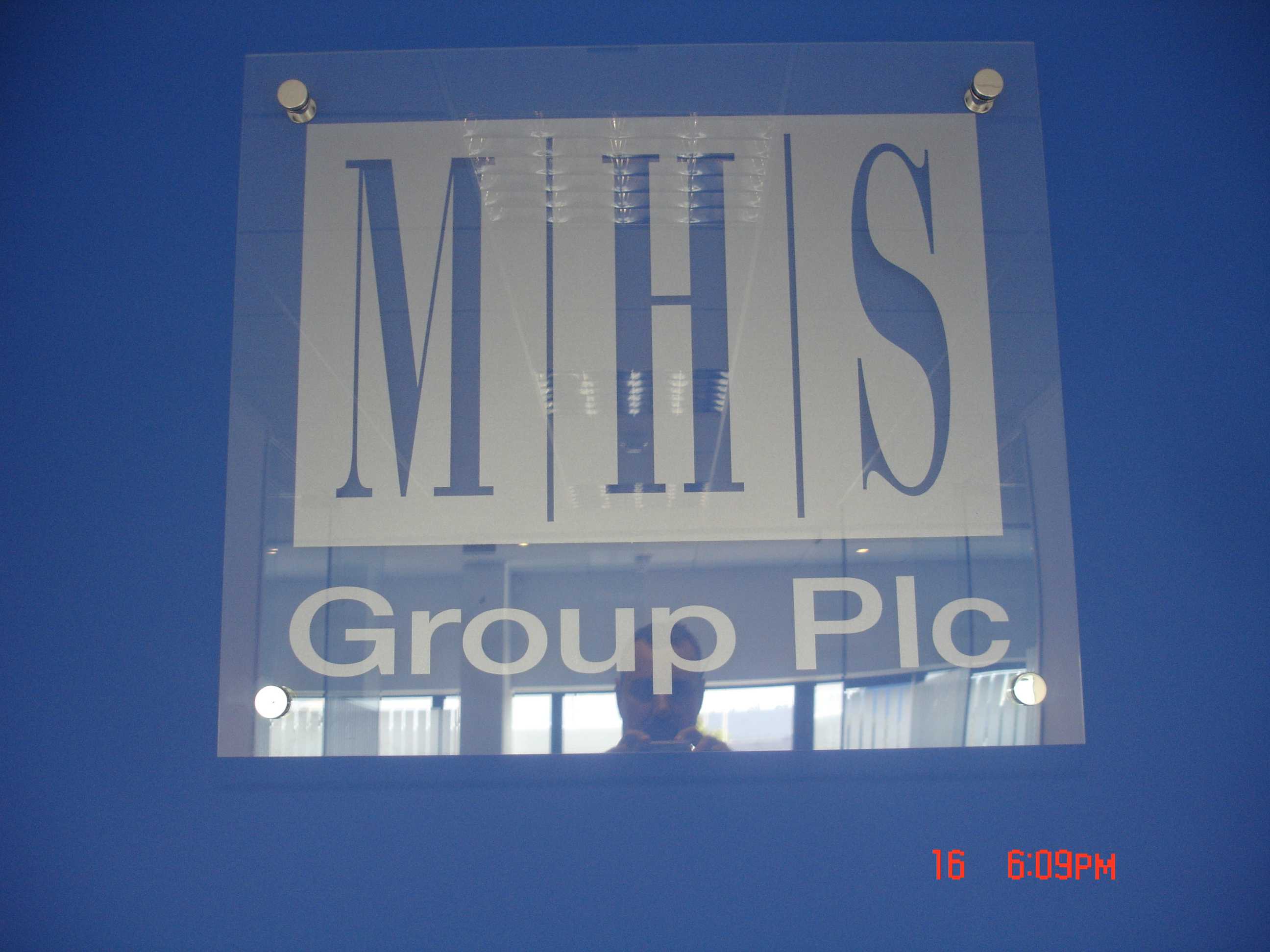

    ive seen several examples posted on the boards… this is a very old one i did. picture is pretty crap to be honest… even a bad angle and at a distance 😕 :lol1:
    October 24, 2006 at 4:28 pm
    here is another i did. this ones a bit better picture but not glass etch. stained glass. 😕

    That’s a great picture Rob. These things can be difficult to photograph.

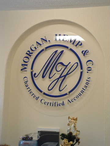

    Here is one with a twist….

    couldn’t agree more Andy, i think i tried about 6 times to stop the flash being caught or my reflection 😕

    is that acrylic or glass mate?

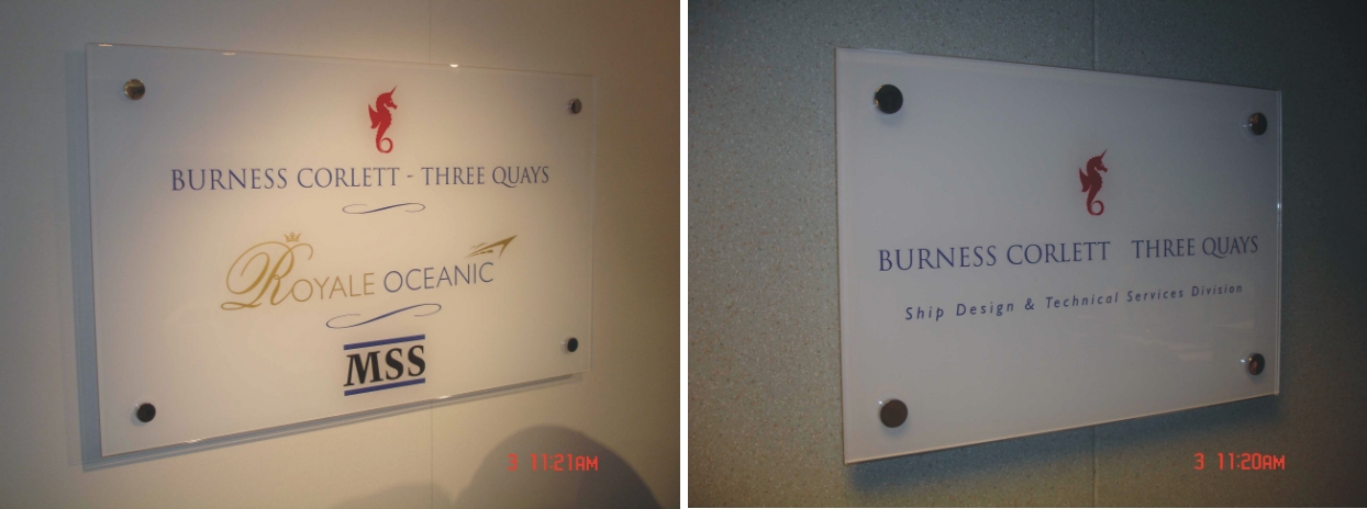

    Bit boring 🙁 but these are the last few I did.
    All on polished 8mm acrylic.
    As Andy says very difficult to get descent photos of these as you can see with the MHS one with my boat race in it.
    The Three quays were done for a third party client for offices in Liverpool Street. The guy was the fussiest person I have ever ever ever had the pleasure to deal with. He insisted on white backings on the acrylic in case the wall got dirty behind the sign and hence would show through 😕 (Paitience of a saint required was an understatement)

    It’s acrylic Rob, and quite large, about 4ft diameter.

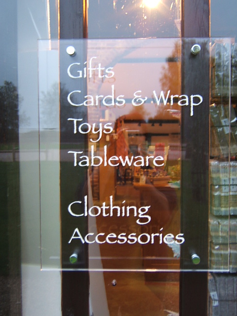

    I did my first one of these a couple of weeks ago, and immediately got another customer on the strength of it!
    10mm acrylic, flame polished edges, text mirrored & on back face.
    not a good picture, as has been said before, difficult to photograph, also as it’s over glass!
