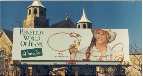

    Here are two pictures.
    The sign was painted by my dear friend Bill Berberich.
    Unfortunately, he has been replaced by computers.
    But he still paints walls with me sometimes.

    April 19, 2005 at 3:26 pm
    How long would something like that take to paint? Amazing work.
    -Marek

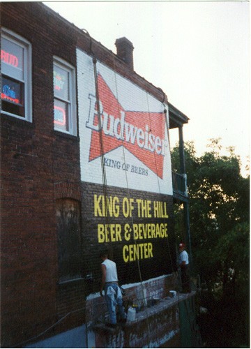

    April 19, 2005 at 3:58 pm
    Marek,
    Bill would make the patterns in house, then pounce the wall or billboard
    with graphite powder,
    then sketch in with charcoal as needed.
    Lettering was usually mocked up on site with a yardstick from a scale drawing.
    He mixed all the paint on the ground (with a butterknife to stir!)
    He is a great posterizer, the pictures up close look like blobs of color but seem to blend from a distance.
    A job like that probably was a decent two day’s painting or better.
    The Butt-Wiper wall was probably done in a day.
