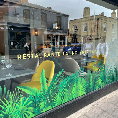

      Thanks Karen, Just used the MDCRV from Metamark and it is really nice, very clear for windows. Three layer print, colour, white, colour ๐Ÿ‘

      Hi Peter, sorry for the delay, yes it has white ink as a middle layer so CMYK/White/CMYK. Tales longer to print but worth it not to have washed out colours with a single layer.

    I was scrutinising your photo there “trying” to see where your vinyl edge was! ๐Ÿค“
    Is it where I have indicated?
    Regardless of “if I have spotted it”. it looks good and I would be amazed if there was any vinyl on the market that was completely invisible.

      Thanks, I used my Mimaki UCJV 160-300 with the white inkset, nice to be able to use it properly for a change. It really is tricky to see the edge of the vinyl, i’m guessing most people would’nt and its a hell of a lot easier than weeding out the shape ๐Ÿ˜ฌ
