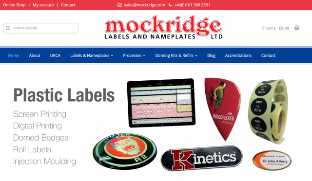

    To add, I’ve had little success with doming, getting it dry, bubble and dust free, and now I print the labels and send the to Mockridge labels who will dome them for me, cheaper than buying in the resin, and the time doing it myself. They will also sell you the resin.
    https://www.mockridge.com

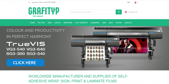

    I used a doming kit from Grafityp a while back. it came with multiple nozzles and liquid and a small dispenser gun.
    https://www.grafityp.co.uk

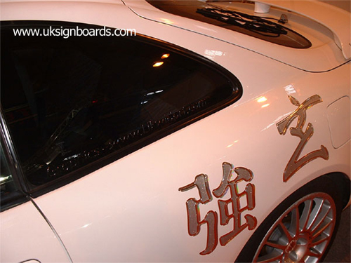

    They caught my eye because they were using liquid resin in many different ways with one being “Vehicle graphics” but not for small badge names. I have attached a photo I took back then.
    I remember way back looking into doing large domed graphics but the cost was unrealistic for anything over 100mm however, prices have come down and i have seen companies that offer 3D liquid domed numberplate lettering.
