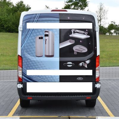

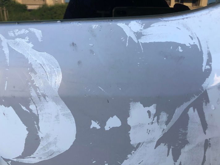

Posted by Pane Talev on June 10, 2022 at 4:12 pmOoo dear. How did this happen?
Vehicle done by me 5 years ago.
Arlon SLX. Full wrap on the back.

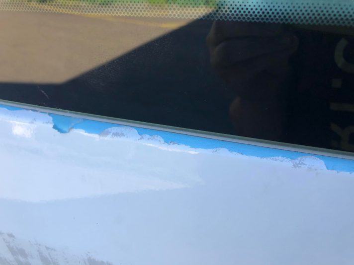

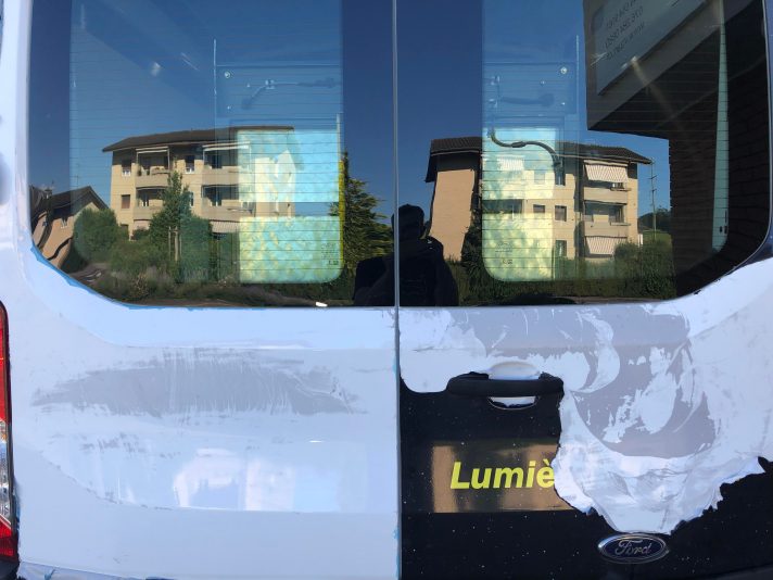

Glass wrapped area was removed within 2 min.
Panel wrap is taking whole day to be removed. I’m not sure what happened here.
What is my best approach to remove this wrap? I have another 3 vans.

Just so I can have a think on this, what type of printer did you use for this?
Looking at the pictures, please correct me where I am wrong.
1: The van is light blue.
2: The wrap is printed solid black with text.
3: The white area covered in the adhesive is the digital vinyl, the vinyl that was printed onto. And where you have stripped the vinyl, only the laminate has come away and is also lifting the ink from the digital vinyl?Was the van new with a factory paint job? by that I mean it was the sprayed the pastel blue colour I can see, because pastel blue is an unusual standard factory colour for a van.
Regarding the Tar and Glue remover that Tim mentions, I use that too, it’s great stuff. You can buy it from auto car valet type suppliers, or janitorial suppliers. but make sure you get a decent branded one as there are many “weak” alternatives.
Also as Tim mentions, use latex gloves and splash goggles because it burns like hell if it touches your eye in the slightest. ( yep, I have the T-shirt for that too 😳)-
1: The van is white

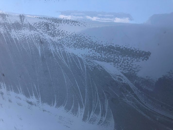

2: Wrap is printed, right door black , left door light blue. Vinyl comes off super difficult even in the folded areas that I have pushed inside. (Edge of door)
3: Vinyl comes off equally difficult everywhere.5: Printed on Mutoh Valujet 1624x
6: Laminate doesn’t pull ink. Clear Laminate does come off the print in the areas next to the glass.
Important for me to remove the plastic part of the vinyl. The glue I can remove easy. Will your recommended product go trough the vinyl?

Having read your reply I totally see that I had “visually” misunderstood what I was looking at! 🤔🤣I think it is more important to give a reason for a failure, rather than just a solution to fix it.
However, I am not set on exactly why this happened because one theory contradicts another.You have exactly the same print, vinyl, and laminate on two surfaces, installed at the same time.
The wrap was removed from the glass “exactly as it should have”. But failed on the paintwork.
This tells you that the surface of the painted doors has created a reaction to the adhesive of the vinyl.
So the blame for the failure is not the vinyl.Vehicle Paintwork:
Paint is like solvent print, it outgassing long after it has dried/cured.
You should never apply vinyl graphics to a vehicle within two weeks of it being painted.
You should never wrap a vehicle within 4-6 weeks of it being painted.
However, this is greatly determined by the method of drying the paint. i.e. the type of paint, was it in an oven, air-dried or whatever?
Without being technical, the paint must release chemicals into the air long after it is dry.
If you apply vinyl onto the surface, these chemicals are trapped below the vinyl.
Because the chemicals must get out, they cannot penetrate back into the vehicle metal, so pushes forward into the vinyl. This can result in micro bubbles in the vinyl days/weeks down the line.
However, if there is an “air release system” in the adhesive, perhaps it’s enough for the blisters not to show. Regardless, the chemicals in the paint often react with the adhesive of the vinyl and can stimulate it creating a stronger permanent bond.
I have even seen this happen with “magnetic panels” left too long on the surface of a re-painted vehicle and the magnetic panel won’t come back off, and that doesn’t have adhesive!Polish:
If these vans have not recently been painted or fresh of a production line. Then the next thing that can cause a reaction is the vehcile “might” be coated in some sort of vehicle polish or chemical that has reacted with the adhesive causing a similar problem as I have described above.
I could say that it may be whatever you have cleaned the van with having an effect on the adhesive, but the fact you cleaned the windows with the same, tells you it wasn’t your cleaner.Printer:
Your machine is a solvent printer and if the inks have not out-gassed long enough before lamination. this is most likely the cause. because the solvent in the ink definitely has adverse effects on the adhesive.
however, if this was the case, there are normally tell-tale signs on the surface of the vinyl also.
i.e. shrinkage, delamination tunnels, curling back, bubbles and more.
However, the fact none of this had the same effect on the windows, again, rules this out too.Summary:
I do not have a definitive answer for the failure. But what you have to accept is that if a failure is happening on one flat surface, and not the other, the issue is created most likely by something happening on that surface. I.e. the paintwork or chemicals used on the paintwork reacting with the vinyl adhesive.Removal:
