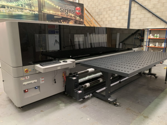

    3 September 2023 at 18:34
    Joking aside, would turning to a trade printer not be an option for you?
    Or speak to David McDonald at Poppy Signs, he has a Platinum Q3.
    https://uksignboards.com/forums-2/discussion/weve-ordered-another-printer-platinum-q3-3-2m-hybrid

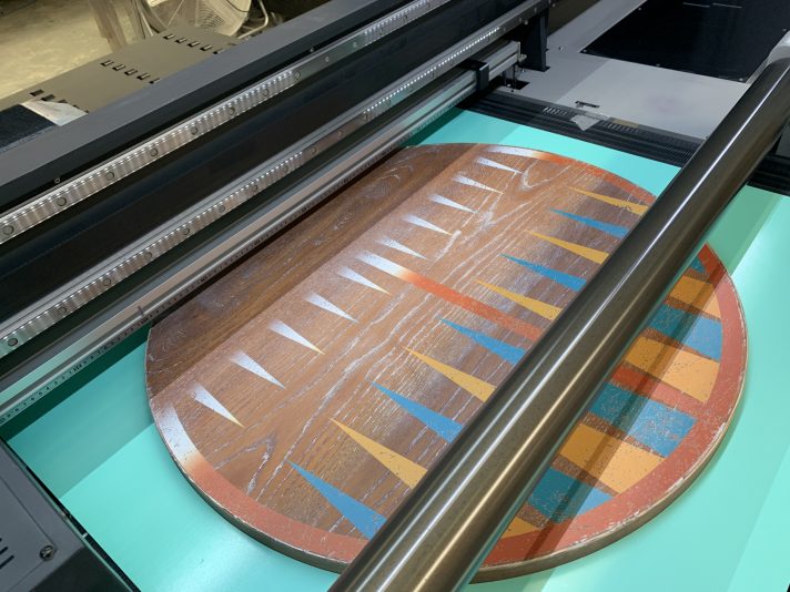

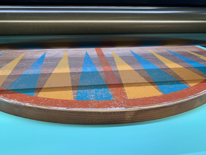

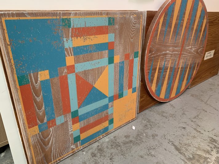

    Hi Dave
    We print a lot of table tops, white backed CMYK. They come into us with a variety of pre-treatments, waxes and lacquers and the UV ink sticks to some aggressively and others a bit less so (the limed effect being the least bonded), when they are just plain raw wood it bonds extremely well. They all get heavily varnished to finish and the level of ink adhesion is 100% fine.
    BTW we design these with a distressed effect – the missing bits and corroded bits are intentional !!
    Rob – thanks for the mention.

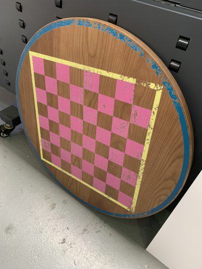

      edit: is pink white on the chess board? presume so… a chess board can rotate 180 but not 90 (so black square bottom left). Love a game of chess
