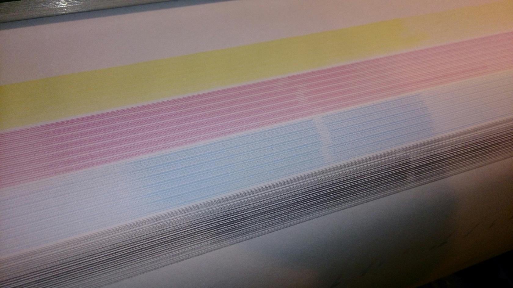

    Hello all, just wondering if anyone can help, i know it’s an old printer but it was working fine up until yesterday when the prints have lines all the way through. I’ve tried updating the firmware but instead of just the one beep to tell me it’s loaded ok i get a series of 6 beeps, any ideas?

    The printer was running perfectly up until the other day and then the lines appeared.
    September 30, 2014 at 8:00 pm
    If it was working fine then it is unlikely to be a cable issue, when did you last look at the rubber wipers on the capping station, I’ve known them to cause problems such as lines & smudges.
