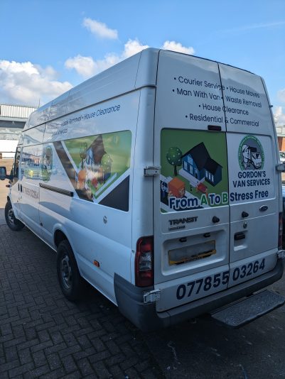

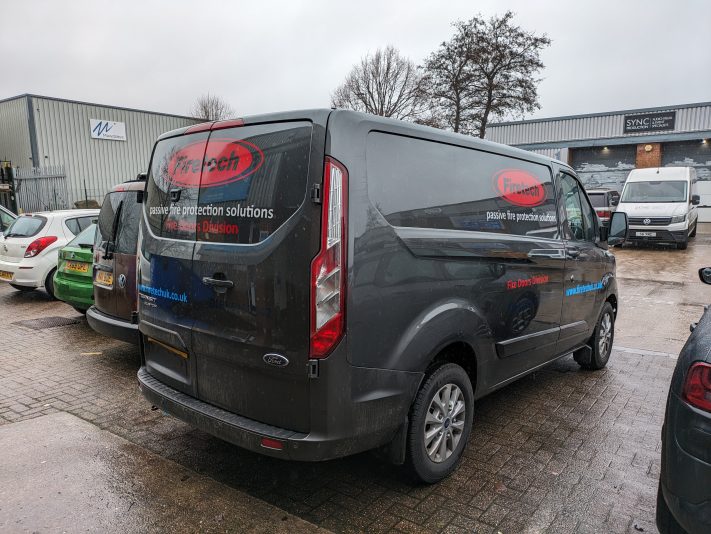

Posted by Martyn on 7 March 2024 at 08:10Hi. I have a new transit with printed rear panel fill. Do you guys use a standard polymeric or wrap even tho it’s not really needed. Obviously it’s not a flat panel but not very curved

Looks to me to be on glass rear windows of the van as theres no recess

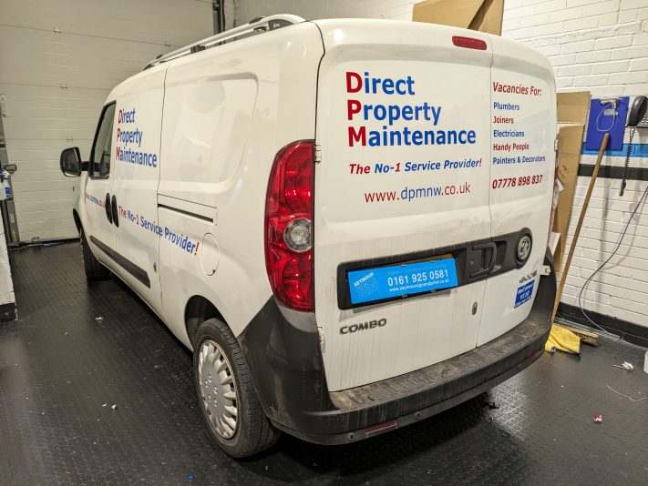

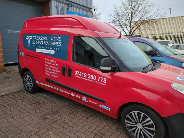

A quick scroll through my photos and all of these are produced using a Quality polymeric, typically M7, or 551.
Or digitally polymeric with matching laminate. This isn’t for a cost perspective, but the polymeric is suitable for these flat applications.Anything going over a recess, then a cast vinyl would be my choice. My issue is with some of these “Hybrid” wrapping films, which aren’t a true cast.

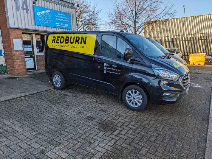

NB, I’ve done over 12 of the redbun vans, and have just got an order for another 14. Allen’s I’ve been working with for a decade, both DPM and Firetech are returning customers, with no issues.
Obviously, I’m UK based, so the climate is different to the Southern hemisphere 🤣

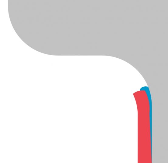

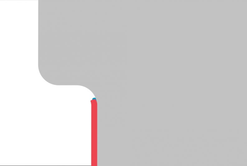

* Air-release adhesive system, (during freezing weather conditions)some may be surprised to see knifeless tape listed. It is a great tool to have in your box, but there are some issues that can arise from time to time.

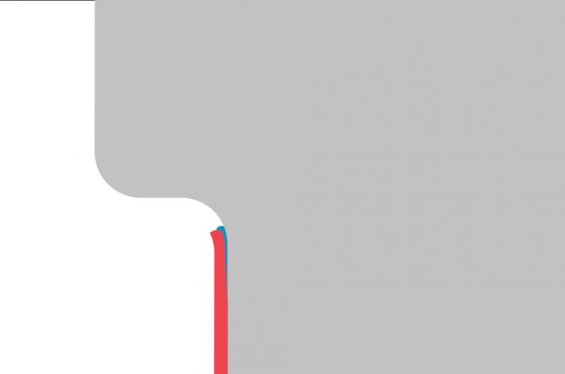

Using knifeless tape, you are reverse-cutting the vinyl by dragging a filament thread backwards through the face of the vinyl. You cannot see it, because it is so small, but you are creating a “LIP” anywhere you are cutting the vinyl. This lip is microscopic but can be visible depending on how clean the cut is.
secondly, when you pull the tape out from under the edge of the vinyl, you can sometimes leave some adhesive residue from the tape. this residue is a bit like “post-it” adhesive, it is a non-sticky gum adhesive. anyway, this can be left behind, trapped under the vinyl around the edge.
Now, worst case scenario…
* You have a Lip created in your cut, along the top of the panel.
* You have some adhesive residue left behind from using the knifless tape.
The lip will act as a shelf to hold rainwater running down the van from the roof.
The residue adhesive will make this situation much worse. But it will happen even if the adhesive is not present.

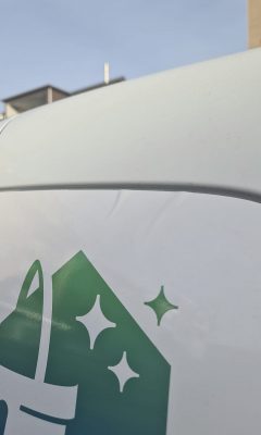

see the attached images for reference if only water is sitting on the lip.If we add “cold metal” of the vehicle body, into the mix. A failure will happen much faster!
This is because there is much less resistance of moisture gathering on the lip. so the vinyl panel begins to come away.
If we add “air release vinyl” into the mix, it could happen faster again if the moisture is able to spread down the cavity of the air channels. if air can travel down the channels, so can water!
Solution
Heat and pressure!
As soon as a panel has been installed into the recess of the vehcile. It is very important that you do the following simple excercise. using a squeegee with a felt edge or your thumb inside a wrapping glove.
warm up the parimetre of the panel you have installed, and while you do it, “in a dragging, not pushing” motion. apply pressure to the edge of the vinyl panel.
this will help reduce or remove the possible micro-lip created by the knifless tape. it will also help bond the vinyl around the edge, preventing any possible water creaping under the vinyl.
It will also help collapse the air channels in the adhesive, again preventing the water being able to travel in the air channels. -

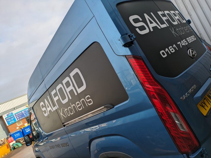

I installed dry, correct.
I got into a stupid habit not to heat the vinyl after finishing my work with slightly curved panels using Matamark MD7A and MD5A and this is the cause of my failure.
@RobertLambie @DavidHammond @MartynHeath @Simon-Worrall1
This question rings in my ears…
We say flat panel, but is not flat panel. It is curved / domed panel or curved / domed glass.
The rear window of a Renault Kangoo, Mercedes Citan or Ford Transit and similar is not flat – it is curved / domed.
All my vinyl failings are on similar curved glass (some mentioned above)
Metamark MD5 Air Release only goes on flat panels or shop windows from now on in my workshop. (until I finish what I have) Then I will not stock the air release version.
Side glass is ok. I haven’t registered a fail. Side glass is not domed in all 4 direction. Only domed top to bottom.
