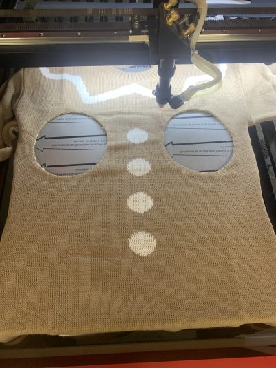

  • Leslie Anderson
    December 12, 2021 at 8:56 pm
    Very interesting “winter” clothing Kevin. as the Christmas song goes, “it’s cold outside”. 😳🤣
    I didn’t know a laser could cut cloth. i would have thought it would go on fire? 🤔

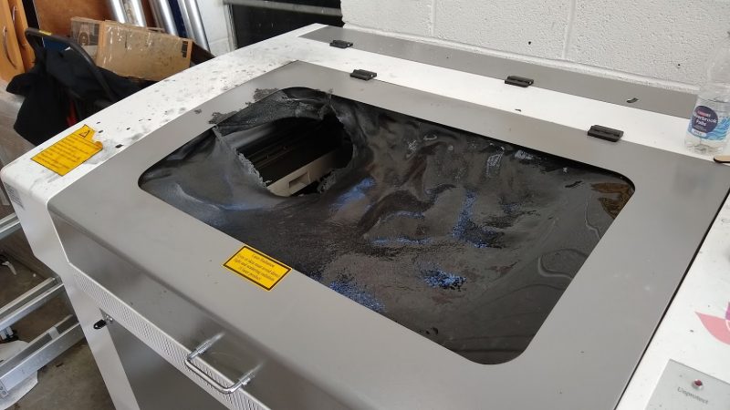

    • David Stevenson
      December 12, 2021 at 9:18 pm
      They can go on fire very easy even cutting acrylic. Ask me how I know 🙁

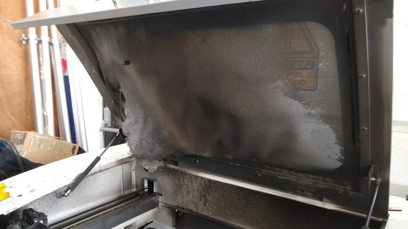

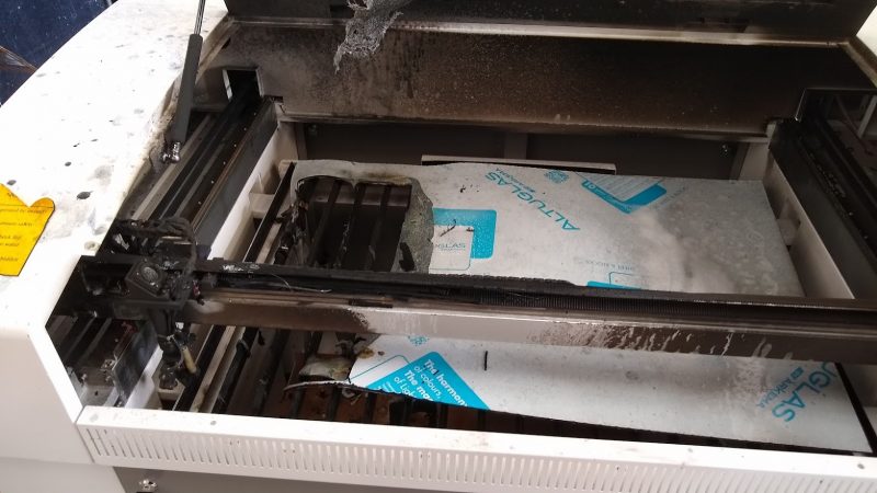

        • David Stevenson
          December 13, 2021 at 2:05 pm
          I’d put it down to an unsuitable product Robert. We were cutting 3mm acrylic and had ran out of the Orcal P.E.T double sided tape we normally use. Instead we used a tape that had a paper rather than plastic backing. We looked in when the job had finished and everything seemed OK. Unknown to us the paper backing tape was smouldering underneath and finally caught fire. We discovered flames shooting out of it around 10 minutes later, our view was obscured by a ice cream van we were working on or we’d have caught it sooner. The real scary part was it happened around 5pm, had it been 5.30pm we’d have been away home and the whole building could possibly have burnt down 🙁 Severe lesson learnt that day. Like Kevin mentioned “turn your back on a laser at your peril”!!!
      • Kevin Mahoney
        December 13, 2021 at 8:42 am
        Was yours written off or repaired David?
        • David Stevenson
          December 13, 2021 at 1:57 pm
          We managed to save it Kevin. Spoke to the guys we bought it from and they sent us the bits we needed and helped us align it again. Amazed it lived again considering the damage. Can’t for the life of us get the scorch makes off no matter what we tried 🙁

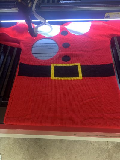

    • Kevin Mahoney
      December 13, 2021 at 8:46 am
      Never done any fabric on it before Leslie, a customer asked if it was possible so gave it a go, had a few glowing embers but no dramas. His wife is currently breastfeeding so this was a joke/time & motion study. I’ve sent her a message saying if she’s selling those puppies, I’ll have the one with the pink nose. So far, no response
        December 13, 2021 at 9:18 am
        …that will be Rudolph then yeh? 🤔
