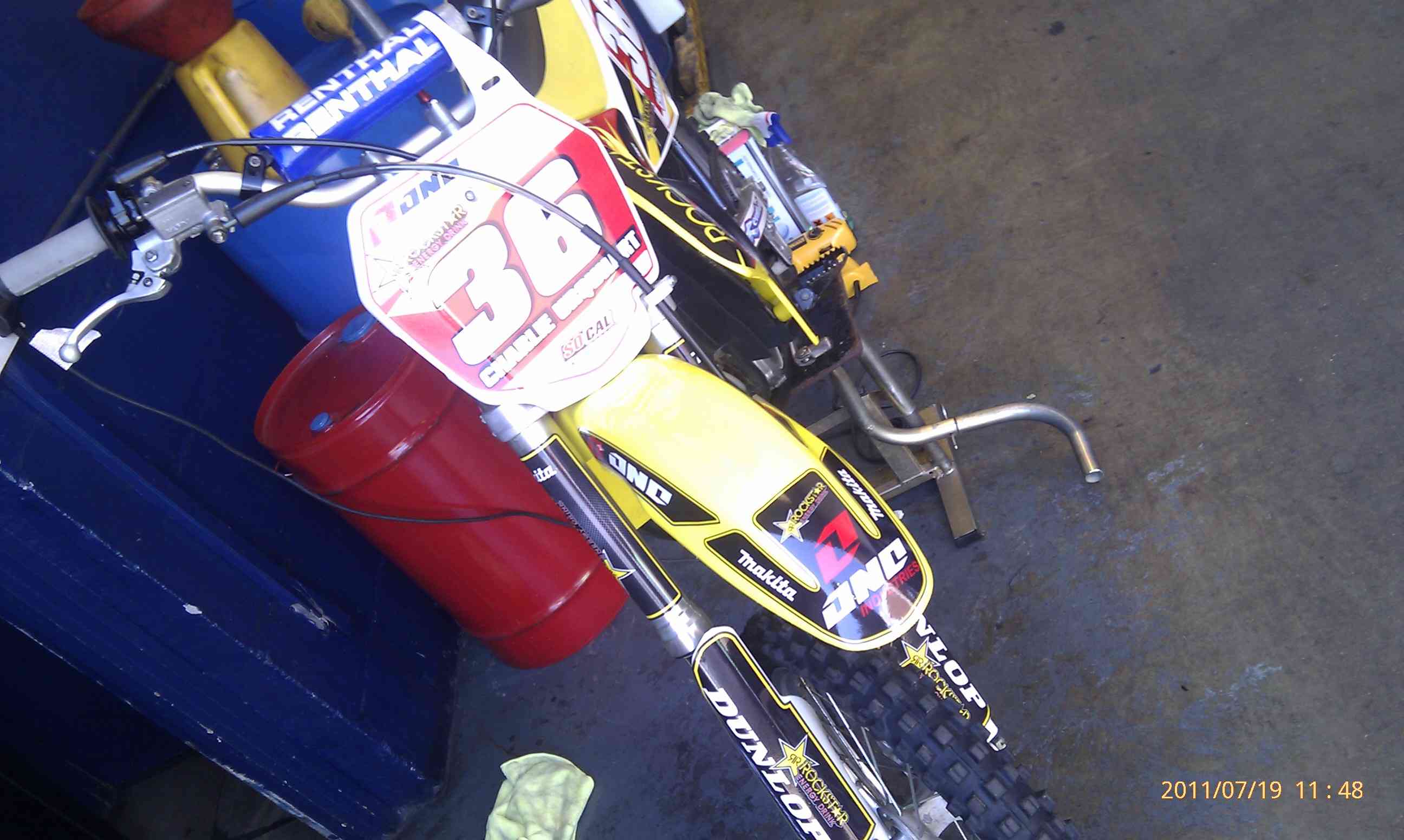

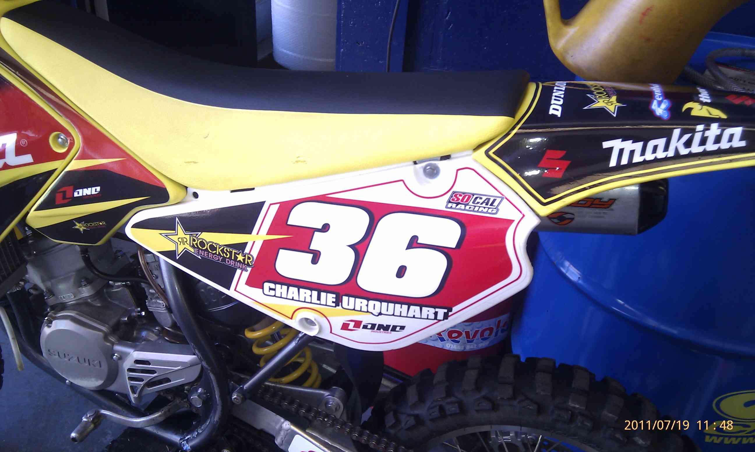

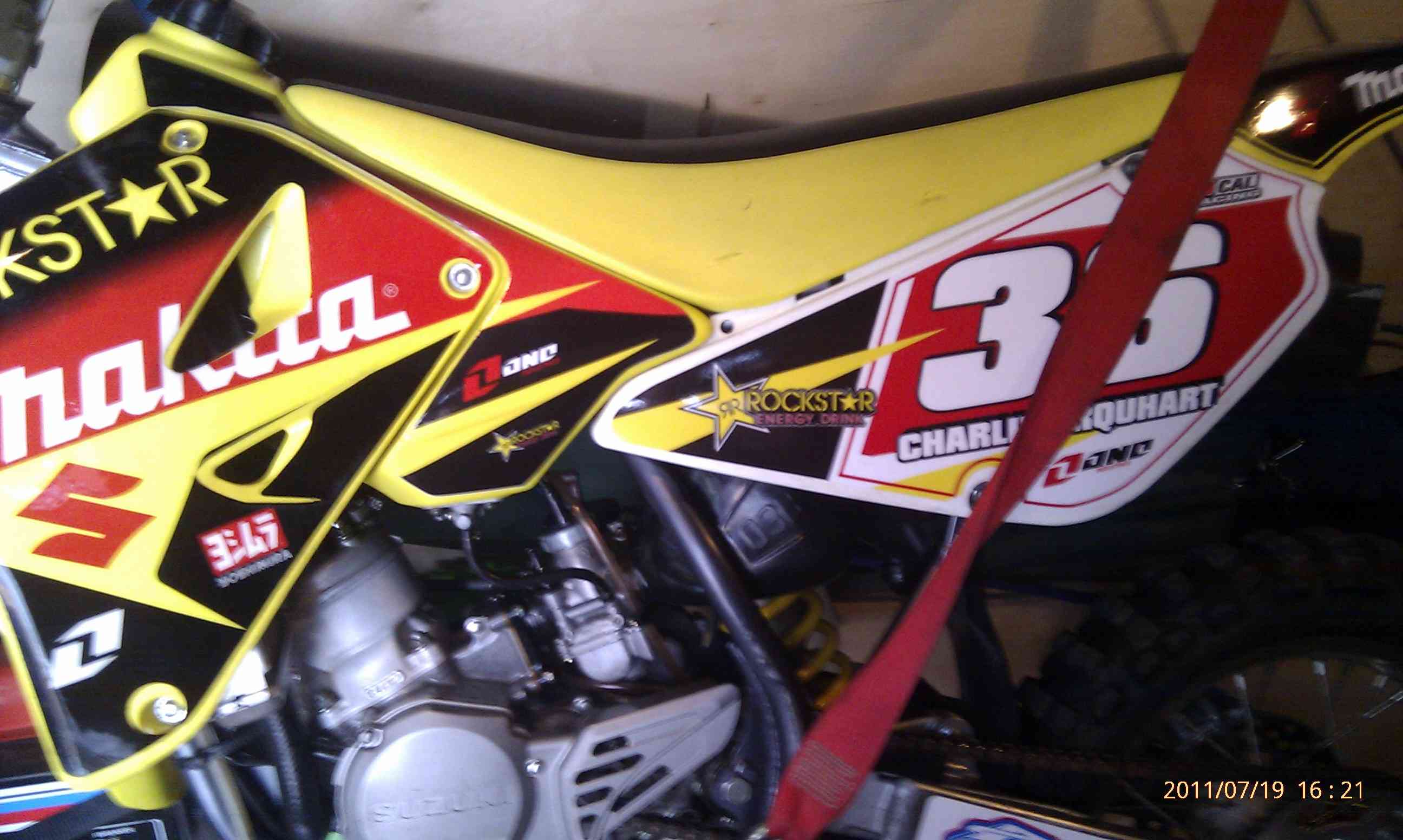

    Just a quick thanks to Chris Wool for advise on media etc.
    I got an outline for my son Charlies bike yesterday and copied a few designs and made this up and printed on Hexis poly prop vinyl and laminated twice, we know it wont last for long but now its just a quick print and cut job, the vinyl was very sticky and has gone on well, so if I get a few races out of it I will be happy. The template had to have some changes but in all a good template to use and cost was just under 30 quid.
    Im sure after having one bike stolen hes going to love this one, complete with his name and numbers on panels.

    25 July 2011 at 14:48
    Just a quick update on these using an incorrect polyprop vinyl and laminated twice.
    My son went out yesterday and rode for 4.5 hours and to my amazement not one edge lifting!! all good will keep and eye on this and see how it lasts but so far the Hexis vinyl has performed rather well !!

  • Richard Urquhart
    26 July 2011 at 08:21
    Jet wash fine, DW40 quick spray and wipe off excess not allowing loads to sit on the edges !

  • Richard Urquhart
    26 July 2011 at 10:59
    John Vinyl was a polyprop hexis vinyl not sure on codes laminate 2 layers of MD5 OR stone chip protector as I can still cut this on my Roland.
