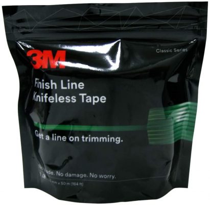

    Personally, I would use knifeless tape and do it.
    When marking out the lines, do it with masking tape as it is easier to see on certain colours and easier to handle, lift and lay until correct. then use the tape as your guide for the knifeless tape.
