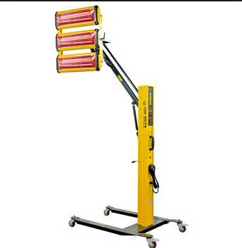

    Back to the installing of any vinyl in cold weather…
    When you apply graphics to the surface of a cold vehicle, the vinyl will instantly become stiff to use, brittle and easily torn. The adhesive becomes hard and will not adhere.
    Room temperature plays a big part, but surface temperature of a metal van is more important!
    You may have a warm workshop, but you pull a metal van in from rain, snow or freezing temperatures outside.
    That vans metal panels will be "below minus" regardless of the workshop it now sits in. This will take many hours to gradually come up to the required temp recommended to adhere vinyl to.
    There is no quick solution to this for the majority of us, but you can take simple steps to help prevent fails.
    Once the vehicle is inside and dried or prepped for the vinyl install, heat the panel you are about to apply the graphics too! you could do this with…
    * An Infrared Heater
    * A hand held heat gun
    this wont take long and using a surface laser temp gauge you will easily see when at the required temp or there about.
    at this point you can start positioning and applying your graphics.
    Once your graphics have been installed and application tape removed.
    using your heat gun, go back over the graphics and heat the same area until you can feel heat in the vehicle panel. not just the surface of the vinyl. once you have done this, then move to the next area of the vehicle and repeat the process.
    Yes this does make the installation a bit longer, but the bottom line is you will prevent fails like we are reading about in this thread.
