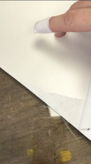

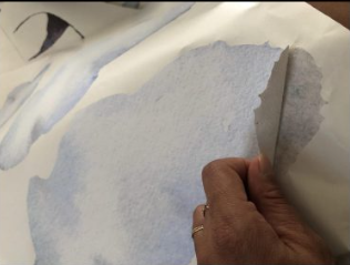

I have been having an issue specifically with the above-named vinyl.
Metamark thinks it is my cutting blade, I, however, am not so sure as the issue is not isolated just around the cut marks, it is also failing in the corners of the vinyl.
Can anyone shed any light on their thoughts, please?MDP High Tack 100 Mic

As you are probably aware, this can happen if the blade is slighty too deep, and cuts into the backing sheet. However, as it is happening in other areas that haven’t been kiss-cut, I would say that it points toward a material fault of some kind.
Looks like a material issue to me….if it’s happening in an area which isn’t kiss-cut, then I can’t see how it could be anything else. Maybe get your Metamark rep in for a visit. Our rep is very good, and always tries to sort out issues.
Backing 100% – and it doesn’t look like the normal backing (no grid and ‘Metamark’)
We’ve been getting a lot of Metamark with no markings on the backing sheet. I was told that there was a shortage, so they had to use unbranded.
Same here, and some of those backing seem ‘different’, not normal high quality.

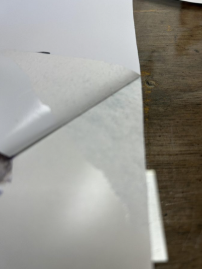

Hi Charlotte
Is the issue happening all to one side of the roll?
By that I mean, all “nearer” the right-hand side edge of the roll or is it both sides and down the middle?-

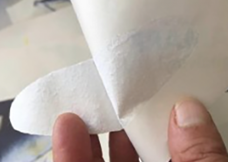

Obviously, I can only go from what I can see in your photos, Video and read, but from this, my opinion is that there is some sort of manufacturing fault.
Blade pressure issue:
This could well be an issue, but I would expect a sharp clean consistent cut line around the graphic.

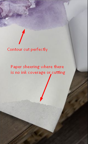

Your pictures show a shearing tear of the paper where the letter has been cut. This isn’t what I would expect to see.Lining Paper shearing down one edge:
This can happen if the roll is placed down hard on its end and something on the floor nicks or crushes into the paper and vinyl. This can create a little tear line that when you peel the paper away, causes the lining paper to shear.

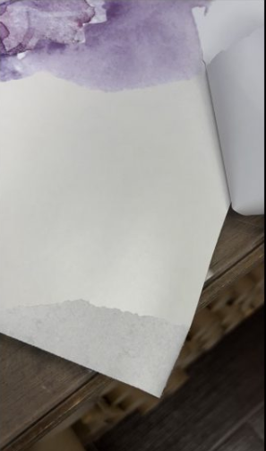

However, looking at the paper along that edge shows zero damage.Looking at another Photo, you can see that although the edge has zero damage and the paper is shearing, you can also see that the contour cut graphics in this photo are cut perfectly and have NOT caused the paper to shear.
If it was the blade pressure, the Paper would not be sheering down the edges of the roll.
What else could cause this?
Damp or moist lining paper that has had a chance to dry out. I have seen similar happen, and doesn’t need to be wet, but stood on end on a cold stone floor without a plastic end cap to levitate the material.
Vinyl that has passed its shelf life can sometimes become difficult to separate from the lining paper, but I have seen that sheer like this.Either of the above normally have telltale signs of warping of the paper, yellowing of the paper etc. I do not see that in any of your photos.
Metamark changing their lining paper may well be an issue, as a result. -

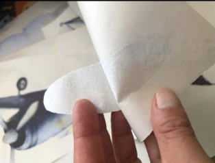

personally I would say that if the backing is coming away with the contour cut graphics, you need to lower the cut pressure so allow for the (probably thinner) backing, that loks obvious to me. A contour cut can be perfect but if it’s too deep, you get what you have here.
Regarding the edge separating, I’ve had it over the years where the backing has some kind of small nick in the edge, which then tears and continues as shown, pulling that torn bit up right away would prevent it continuing, though not ideal. It might be that the edge isn’t as cleanly cut, either from factory or on the bench. I’ve also had it happen on site when the edge of the backing has got wet and it delaminated the backing like that.
I can’t say for sure that it’s not the material at fault, but I would be looking at the blade pressure first, then take a look at the roll edges.

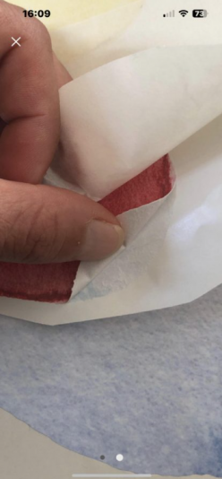

I did a job yesterday.
All test cuts here in workshop were ok.
At the time of installation the following day, the vinyl was not coming off easy from the backing paper. I had same tears like you have on the photos.
This situation will be a tricky one to judge I think.
Using a tweezer I managed to fix everything.
I will be asking a client to sign a waver (for self installation) from now on for high tack vinyl.
ORAJET 3554 Brick Stone Film
Happened to me before also on the solid colours high tack from Mac Tac.
Sending these to clients for self install is risky. If paper doesn’t release quickly client will not bother with tweezers and knife to pick up letters. So you either cut again for free, or lose client…
