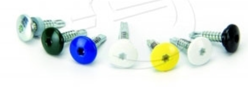

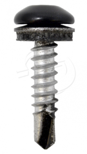

    If the screw head will be seen, I prefer self-drilling with a coloured head version, instead of a Tek Screw with a coloured cap.
    Self Drilling Colour Headed Screws – 25mm

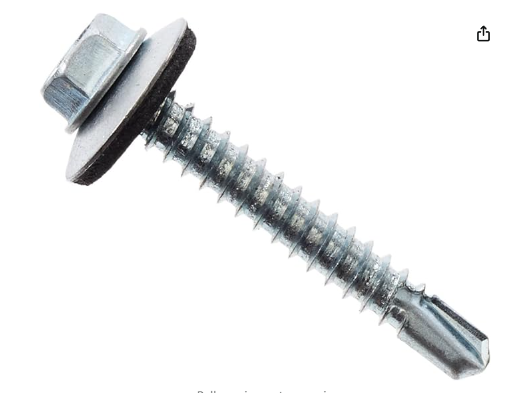

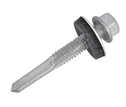

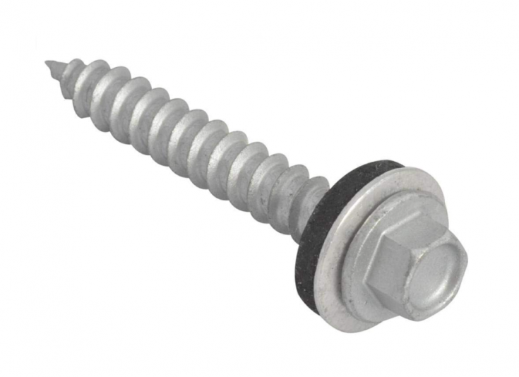

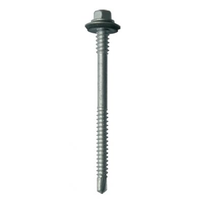

    To keep it simple, I have attached pictures of 3 Screw Tech Screws.
    1. The one with the OPEN threads and Spade Tip are used for drilling into general thin steel and aluminium.
    2. The one with the TIGHT threads and Spade Tip are used for drilling into hard steel frames and beams. (Do not use on general metal cladding buildings or alloy)
    3. The one with the OPEN Threads and Pointed Tip, are for drilling into wood.

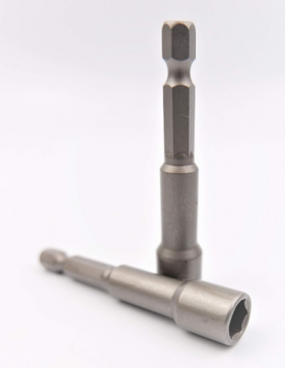

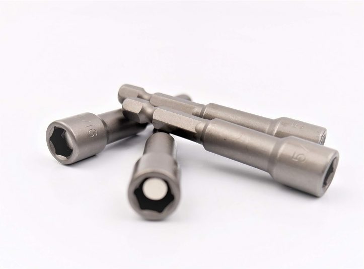

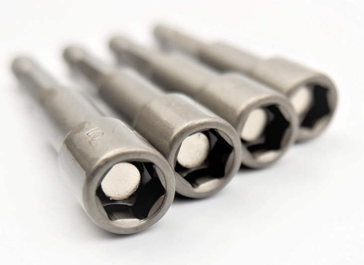

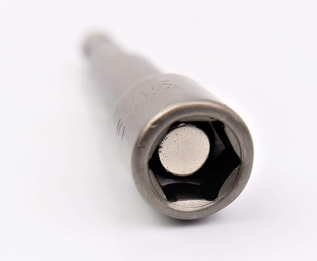

    Also, regardless of the tech screw you choose. You are going to need a Tech-Bit to drive the screw.
    You can buy these screws and the bits from Amazon, Screwfix, Toolbase etc.
