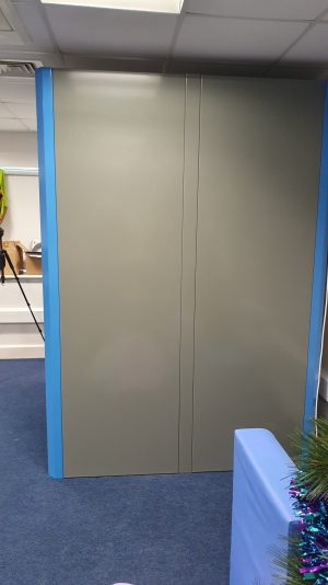

    I’m just looking for some advice/opinions as to what sort of print media would suit this application best.
    Although the customer is calling it a wrap, I don’t think it warrants a wrap vinyl!

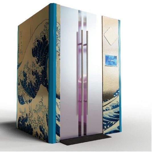

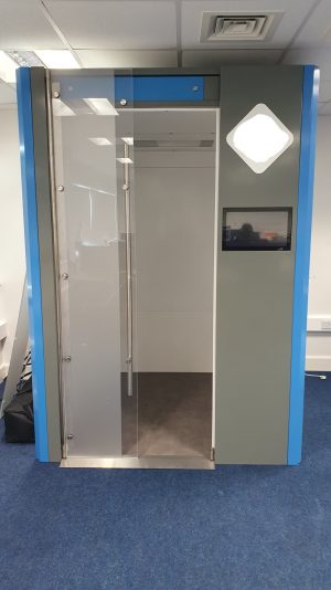

    It’s only the large flat grey areas being covered & fed into panel joints as can be seen in the example below.
    Initially when I first saw a small image of the unit & couldn’t really make out the surface finish & thought it might be brushed aluminium so was considering a high tack vinyl, but having now seen it 1st hand & see that it is pretty much just flat smooth gloss surfaces I’m thinking that maybe even a removable vinyl may work?
    Has anyone had experience of “wrapping” similar type units?
    It will need to meet the following specs:
    To be hard-wearing & durable as the booths will be located in special needs schools.
    Potential to remove & replace individual panel graphics if damaged. (Graphics will be split at panel joints) But without risk of lifting/shrinking.

    Looking at the photos, this is pretty much flat panel work that will require some trimming and tucking of the vinyl. A decent brand of Polymeric is more than suitable, using an equivalent laminate.

    Looking at your photos, I would also have said that it looks like the image has a metallic sheen/finish.
    Be careful that they are not expecting the prints to have this style of finish. I say that because you can print to metallised type finish vinyl that will have this metallic sheen from beneath the print. I am sure it will just be regular print, but it is always worth asking the question.
  • Jeff
    January 11, 2024 at 3:03 pm
    that definitely looks like it has a matt metallic finish below the print, Myles. it might even need a white ink first pass to get the colours sharp or they might look washed out.

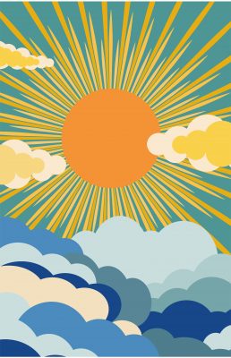

    Just a quick update having just received the artwork they want to put on them.
    It’s thankfully not a metallic finish so no problem there & no need for any white ink etc.
    My only issue now that I really should have thought about before. Whilst I can print onto 1520mm wide vinyl it suddenly occurred to me that my laminator is only 1400mm wide!!🤣😭 Dohhh!!

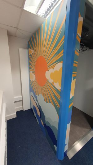

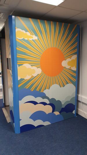

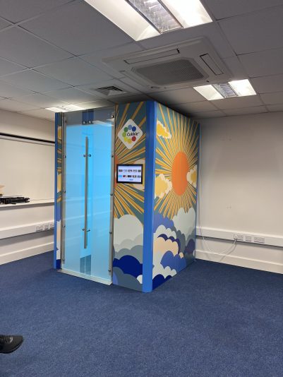

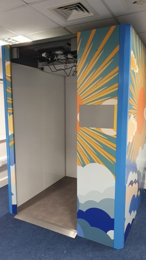

    I thought I should come back to this thread having completed the job some time ago now & it all went perfectly to plan in the end, just using Avery 2800 with matt laminate. Customer was very happy & hopefully there will be more to come now too. 👍
    May 12, 2024 at 8:35 pm
    Hi Myles
    The finished job looks great mate. And thanks for taking the time to update and complete the post Myles, makes all the difference to people googling and finding a relevant post, from start to finish of the process. 👍
