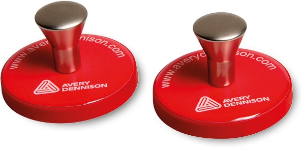

      another thing to try is the suede vinyl wrap ive got that on mine at the moment i dont notice any loss in strength these are the avery red mags

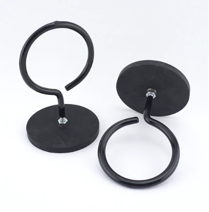

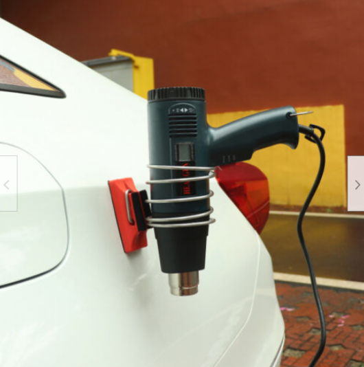

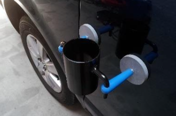

    Just thought I would add this to the topic of magnets damaging the vehicle’s paintwork.
    Magnetic Heat Gun Holders, I do not use these for various reasons.
    They come in all sorts of shapes and sizes and are used for holding heat guns on the side of a vehicle.
    Not only do you run the risk of staining the vehicle’s paintwork, but just by having it there, you open up accidents happening, like hitting the car’s paintwork with the hot end of the gun. Scratching the paintwork. because these magnets pick up tiny bits of magnetic debris on the surface, even little hard bits of dust. then whack on one of these powerful magnets and damaging the paintwork is on the cards!
    if the gun is heavy or the cable tugged, the magnet will turn and twist whatever is on the surface against the paintwork.
    do not get me wrong, the idea of the tool is OK, but there are too many accidents that could happen to justify using them. I would rather drop a ยฃ40 heat gun on the floor than have to pay for a customer’s car respray.

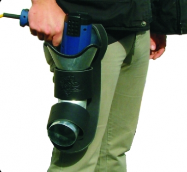

  • Richard Wills
    May 11, 2022 at 5:38 pm
    “You
    can even leave the gun running, the metal holster directs the heat away
    from your body and the wood backing insulates you against direct
    contact.”
    Wonder what damage that could cause to a vehicle…
    May 12, 2022 at 2:42 am
    The holster is a much better option than one of those magnetic car holders.
    However, they are completely over-engineered. Stuff walking around with a drainpipe and gutter, strapped to your leg!๐Ÿคจ

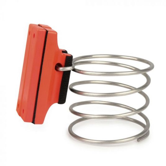

  • Tim Hobbs
    June 10, 2022 at 10:16 pm
    Just thought I’d put in my half penny worth on the heatgun holders. I use the spiral coil type, one of which is illustrated in Rob’s earlier comment. I find them really useful when wrapping high sided vans, stood on steps in particular. Where I kept dropping my heatguns previously. However, I agree with Rob that they should never be put onto the vehicle itself. I bonded squares of galvanized steel to the workshop walls at strategic points and I simply attach the holder to those when I need to. So don’t write them off completely.
