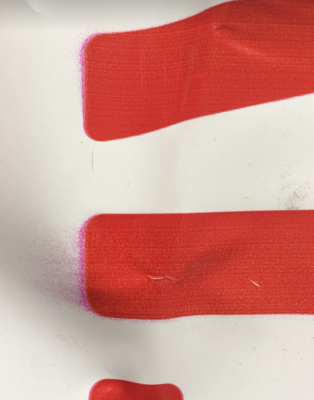

    I have an old Roland SP540V, and Im trying to get a couple more years out of it.
    Up to now its been a workhorse, and has mostly treated me well.
    Yesterday it started to do this, half way through a print. The Magenta was not landing where it was supposed to.
    As shown in the pic, it landed to the left and the right of the target.
    I turned off the printer for a few minutes, and tried again, and this time it was perfect for the rest of the day.
    Its not missing any gaps, just seemed to be spraying everywhere.
    Is this indicative of the head going bad? Or is there something else – pumps, pipes, electronics, etc?
    Any help would be much appreciamacated.☺

    Hi Simon, have you cleaned the encoder strip?

    Thats a good suggestion.
    I did do that three weeks ago, so I assumed its not that, but I am open to the possibility.
    Its not really the same kind of wandering effect you normally get with the encoder strip, where the whole design wanders side to side over the print – but I will clean it tomorrow when I get in to work – just in case you are correct.

    I had similar issues with my SP300 and it turned out to be the encoder strip just as Kevin has suggested. Try turning it upside down and refitting it

        Yes – the strip is symmetrical, half is in the guide and protected and half sticks out. If you turn it upside down the half that’s in the guide is like brand new. They’re not expensive but turning it over could be a quick fix.

    If it’s never had a new drive cable fitted to the head carriage, that might be worth looking at, they may stretch over time & your heads will be all over the place. How old is your versacamm Simon?
