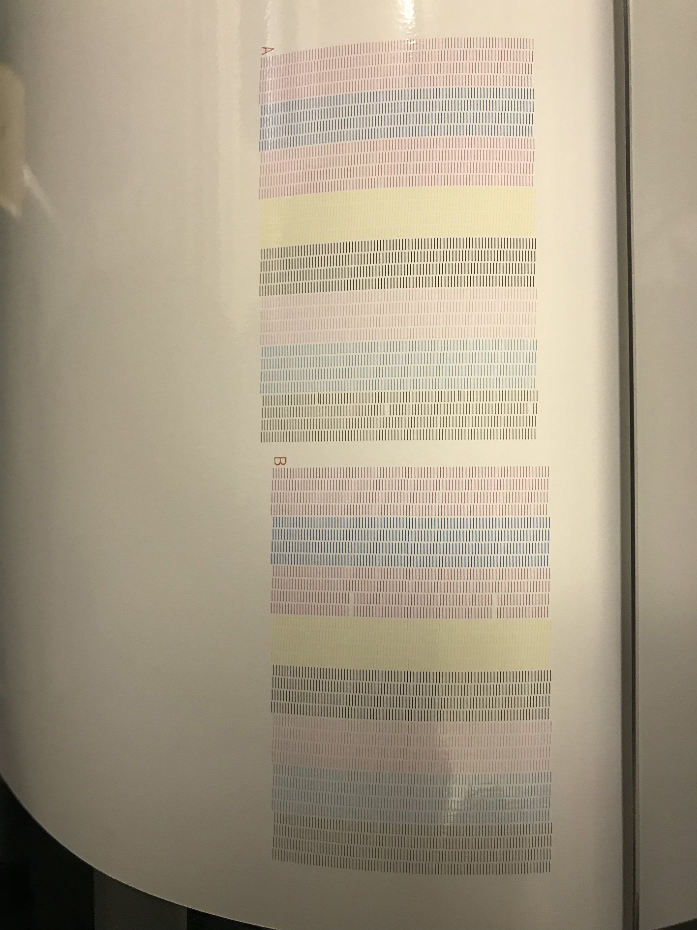

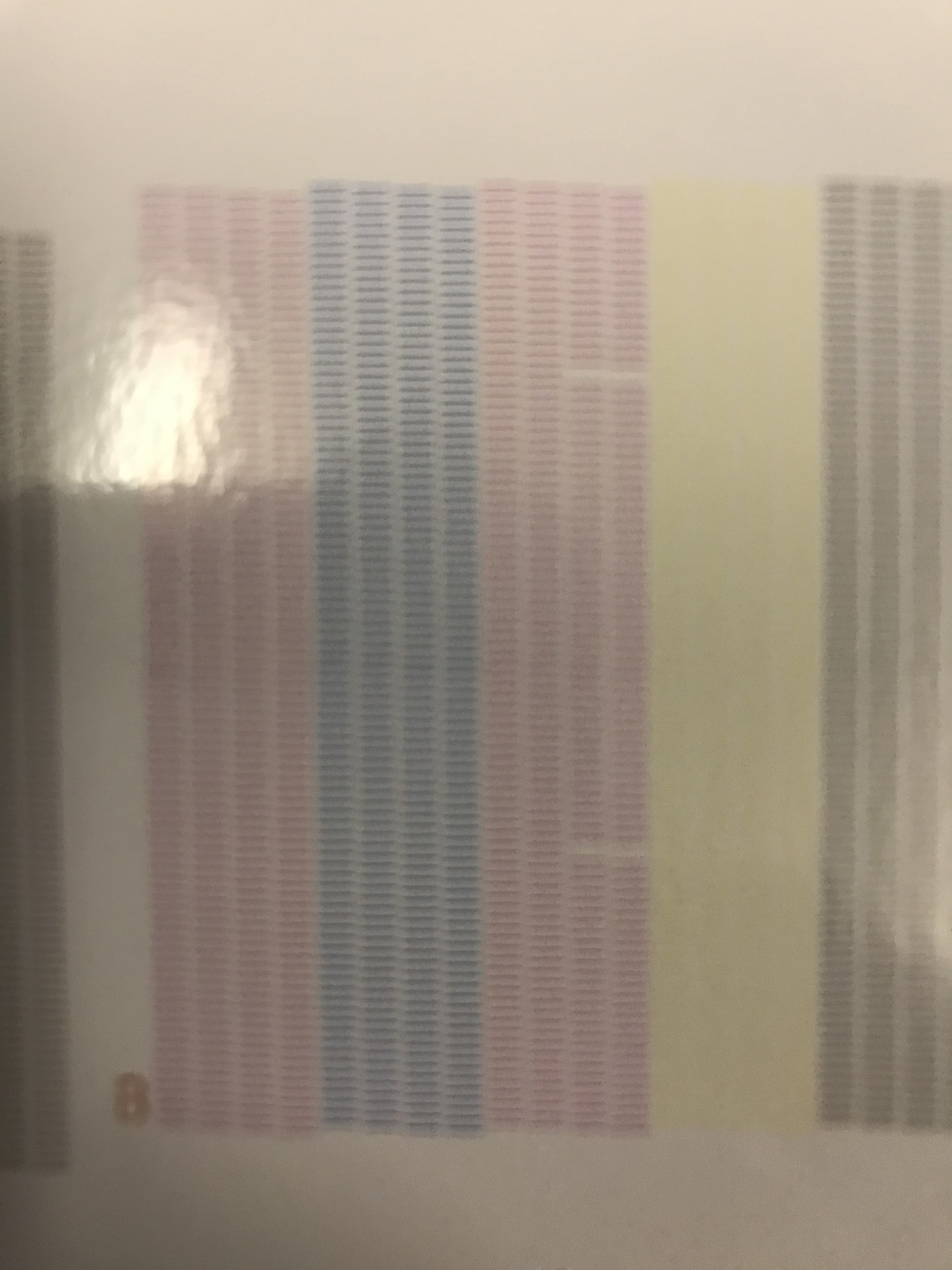

    hi guys i have the EJ640 roland and I’ve just started getting some banding one the magenta and reds which I’ve never had before?, I’ve done a maintenance clean and a test print shows a couple of imperfections, also changed the felt wipers as well and cap tops look in very good condition. any ideas would be appreciated cheers in advance. ( just done another powerful clean and a medium clean on each head and the magenta still showing with those 2 gaps ?

    I would say having those nozzles out on the magenta is probably enough to cause this.
    Have you let the heads sit in some cleaning solution in the capping station to see if this will clear them.
    Fill the capping station up with cleaning solution once heads rest in the caps turn the power off and let the heads sit for a while.
    This has worked for us in the past.
    Or if you in warranty and can wait let Roland deal with it
