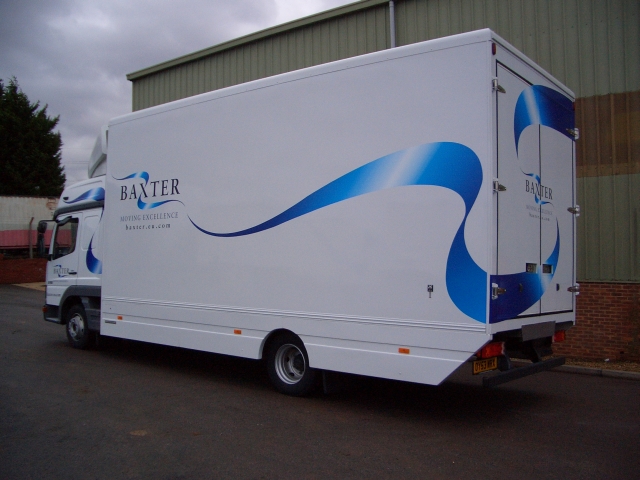

    Next is a Atego 7.5 Box i have done for Baxters, these graphics were supplied by Baxters.Took me about 4 hours to fit on my own.

    January 15, 2004 at 7:11 pm
    hi wardie
    i really like that ribbon type image you have on the second vehicle.
    very effective indeed. can i ask how you did/printed it?
    thanks for sharing mate.. tope notch stuff.. loved the actros too.. very cleans and sharp design but the second one had stole the show for me 😉

    The Baxter is an ongoing contract, I have been asked to do all the fitting as they already had the graphics made some time ago.
    From what i can make out, the graphics on the vehicle pictured here came from 2 suppliers. The cab “ribbon” is made up of 6 parts per side, this makes me think it could have been done on a Gerber Edge. The Body graphics came on sheets 1200 wide and printed on Avery vinyl. The side “Ribbon” was made up from 3 parts.

    HI Wardie,
    Love the ribbon stuff. Where did you start on the back to get everything at the right angle and meet up? I see you applied over the rubber door seal, does this generally stay put? The one lorry I did I was advised to cut the vinyl off the rubber as I was told it wouldn’t stay.

    Started with the sides.Aslong as the ribbon hits the top or the bottom, you can “play” with the rear to fit.
    As for the rubber. Ive had no problems with cast on rubber really.I use plenty of heat on it.
    In total this month, i have fitted 9 tractor units Ategos, Magnum etc & 4 7.5 Boxes. 2 more days of fitting next week and we (I) should be done.
    When i do the next 7.5 box, ill take some Pictures as i do the job.

    Windy….. Thats the problem you see, the Ribbons were supposed to be straight lines!!!!! (hot) 😮 😳 😛

    Shame that on the back there’s masses of space to stick the wording and web stuff but it landed on the centre
    As you say you didn’t have much say over the design
    Looks great though, specially the ribbon! 😀

    I think you may get bother with the vinyl covering the rubber though.
    Maybe not straight away but a month or so down the line.

    Yeah maybe, thats why i cut the vinyl each side of the rubber, so if it does lift, then it can be removed.
    Again im only fitting these, no design on my part & im just copying the rest of the fleet.
