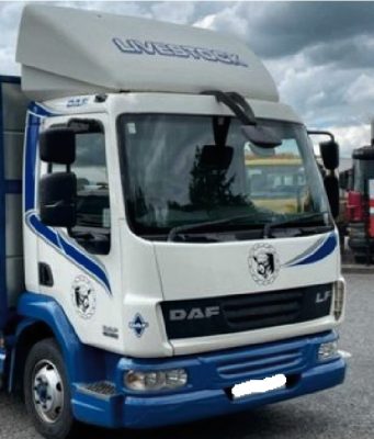

    I have a customer who would like me to either replicate or do something similar to these stripes on a very similar lorry cab.
    Not something I’ve had cause to do in the past & I can’t seem to find any suitable stripes that would fit despite trawling through the many vector graphic books I have & doing extensive interweb searches on vector sites. Maybe I’m just not searching for the right thing (Lorry cab vector graphics/decals/stripes etc)?
    Does anyone know if there is a particular place this type of vector graphic can be got from? I’m not averse to having to tweak them to fit if required but would rather avoid having to design them completely from scratch if I can.

    Do you have a square on picture of the side of the cab and one for the front?
    • Myles Brewer
      8 November 2021 at 16:33
      Hi Rob, Unfortunately not for the DAF with the graphics otherwise I’d just trace them. That was just the pic the customer sent me. I might possibly be able to ask where he saw it, It’s definitely not one of his so I presume he just snapped it himself or got it from Google.

    <div>Hi myles, these types of vectors are very hard to find and often look pretty dated hence why they available.</div><div>
    I think with this picture you can get a good idea of what they are looking for. i would go ahead with drawing up your own visual making sure you keep it as simple as possible. None of these graphics look like they really follow the line of the cab which is the biggest problem making them mm perfect.

    You’ll find this really simple to do just with a metre ruler, a couple of wrap magnets & your phone camera Miles. Stand back & take a side on picture with the ruler attached with the magnets. Import the photo into your design software (I also photoshop the ruler out because it kills me to present it to the client) then mock up your version of the design & print or cut your stripes. This kit used less than 2 metres of 54” material. We do quite a few fleets like this. First image is the rendering sent to the client & the second one is the actual install, printed in sections to suit the material you’re using & fitted like a jigsaw puzzle with a slight overlap at the panel edges for trimming. The scale is pretty much dead on

      Thanks Kevin, I’m actually familiar with using that process for vans & know it works very well & actually made myself a magnetic ruler specifically for that purpose.
      I’ve actually managed to get hold of the dealer that is selling that lorry this evening & they’re going to email me some pics in the morning of the side of the lorry cab head on, so hopefully I should be able to trace them & then just tweak them to fit my customers cab which I have good pics & dimensions of.
      The issue was trying to get better pics of those particular graphics which he had wanted.
