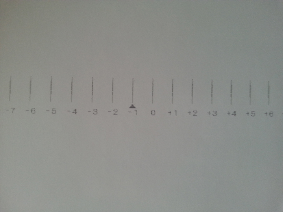

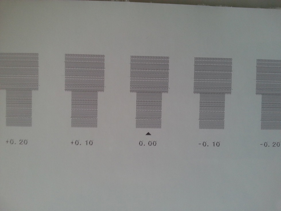

    Have real bad issues with my Versacamm, banding, overspray etc
    Tried everything, but cannot set the media feed calibration as the prints come out so banded that I cant see the join on the "T" shape
    I will post some pics soon
    PS If I do set the media feed on the machine for each vinyl do I need to turn this off in Versaworks as currently the "feed calibration control" is set on use default media settings. I would have thought that this setting comes from the media profile and might override the printer settings??
    Thanks for any help in advance

  • Stafford Cox
    September 21, 2014 at 4:07 pm
    That calibration is always difficult to set up with that amount of deflection unfortunately. Your best bet would be to concentrate on getting the K printhead running better then everything should fall into place.
    P.S, we cover your area too if you’re really stuck.
    Stafford
