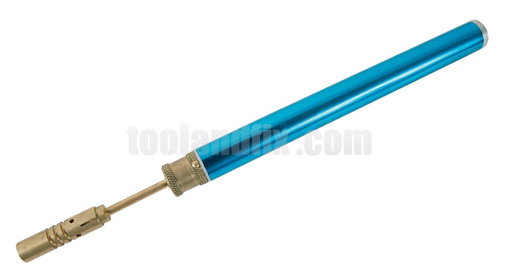

    If it’s any use and not too late… I use a small soldering / plumbers torch. Think it was about £25 from machine mart & fills up with butane lighter gas.
    Works a treat on small stuff but takes a while on large panels.

    Thanks for all the replies. In the interim I brought a pencil torch for 3.00 inc vat and delivery to try!
    Works well (thanks Glen)
