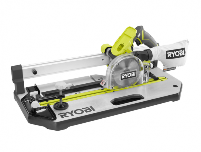

https://www.ryobitools.com/products/details/33287190577?bvstate=pg%3A2%2Fct%3Ar
Above product almost qualifies. 15″ cut line is rather small.
I want to be able to make nice cut without any fitness involved. (fitness being plane edge with the planer)

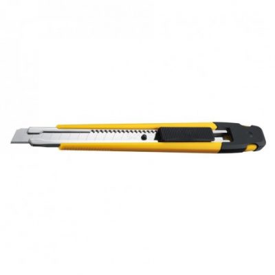

Hi Pane, Not sure how much pressure you’re using when cutting DiBond but try very gently scoring it with a knife similar to this. You’ll be amazing how little force it takes to get it snapped which leaves a perfect edge. We’d a small circular saw for cutting it but like Simon said the mess is incredible. A 30 degree blade in the knife rather than a 45 degree cuts better I feel.

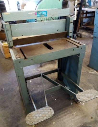

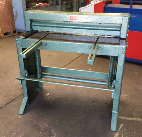

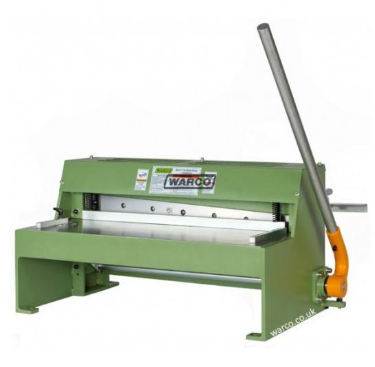

@Craig Thompson

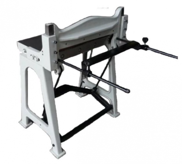

I have to agree with Craig, nothing compares to an old-fashioned guillotine!
They come in lots of sizes, from 300mm up to 3 or 4 metres wide.
I would advise you to get a manual or electric foot-operated one, but you can also get a desktop arm operated. but i think foot operated is far better.
Cutting a sheet of composite into bits in seconds and every cut being perfectly clean, is brilliant.
You can turn your off-cut waste into small signs very quickly and easily.
I have gone from a small guillotine up to an electric foot operated 3m wide one. I couldn’t do without it.
We purchased our largest one at an auction over 20 years ago. the machine is an old-fashioned Morgon guillotine and it just keeps on going.
Try ebay or local auctions for one, they are always on sale.
I have purposely attached various-sized old-fashioned ones. do not be fooled by the look of them.
i have also attached a photo of on thats new and a price. the 1000mm wide and 1320mm are the same price on that site, but you will get them much cheaper second hand. https://www.expondo.co.uk
some will say cuts up to 1.5mm but that is “steel”. You are cutting soft composite. All you need to make sure is that the blade clearance of the machine is more than 3mm.-
