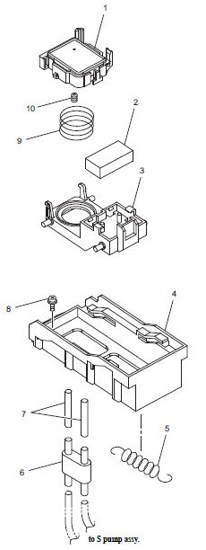

    The sponges are consumable and come in packs of 10 and are part number SPA-0161. You also get a sponge when you buy a complete assembly so that might be an option. Whenever I fit them I give the whole thing a strip down and clean out as they do tend to leak from time to time, especially when running the pump clean or nozzle wash frequently.
    The compression dampers develop either a weak valve or stretched o ring. Other than that, the occasional split membrane but you’d know about it if that happened.
    I’ve attached an exploded diagram of the capping station, let me know if you have any other questions.
    Stafford.

    That’s great, thank you. i was trying to find a parts fiche but couldn’t see one. Out of interest, do you have a link to the whole printer so I can see where all the bits and pieces are
    I think I will replace parts 1,2,9 & 10 then(guessing 9&10 are a spring of some sort so figure it can’t hurt to refresh those)

  • Stafford Cox
    December 23, 2015 at 11:33 am
    No problem. I wouldn’t bother with 9 & 10 to be honest. Whenever I do them on customers machines I use the bung from the original cap and have never had to replace one of the springs on any of the machines I see. And in 20 years of maintaining them, there’s a few 🙂
    I can’t send you the whole diagram as I’ll be strung up but I can certainly look up any parts you might need. We’ve got all those parts in stock but not sending out any more parts this year as our courier turn up after 4 and I’m hoping to have closed the office WAY before then 😉 If you’re stuck though we can help in the new year.
